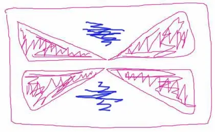

Which parts are active on a Studer B67 head?
Hi guys,
I wonder if you can help me. Which parts of a Studer B67 head is active?
If I can see some wearing on the blue parts (see my home made pic) but the red parts seems OK, am I OK then do you think?
Hans
A little bit of wear is not a huge problem as long as the wear is even!
If your heads are being worn down unevenly, it may limit the possibility of doing a re-lapping of the heads.
Generally, when the head is near gone, the hum levels come up, the highs go down and the deck may distort more quickly. Also excess shedding of new, healthy tape is a warning sign that the path is a bit jagged.
You should also inspect your guide posts and lifters for wear. If they are showing flat spots, rotate or replace them to keep your tapes healthy.
How does the deck sound currently?
Cheers! :)
