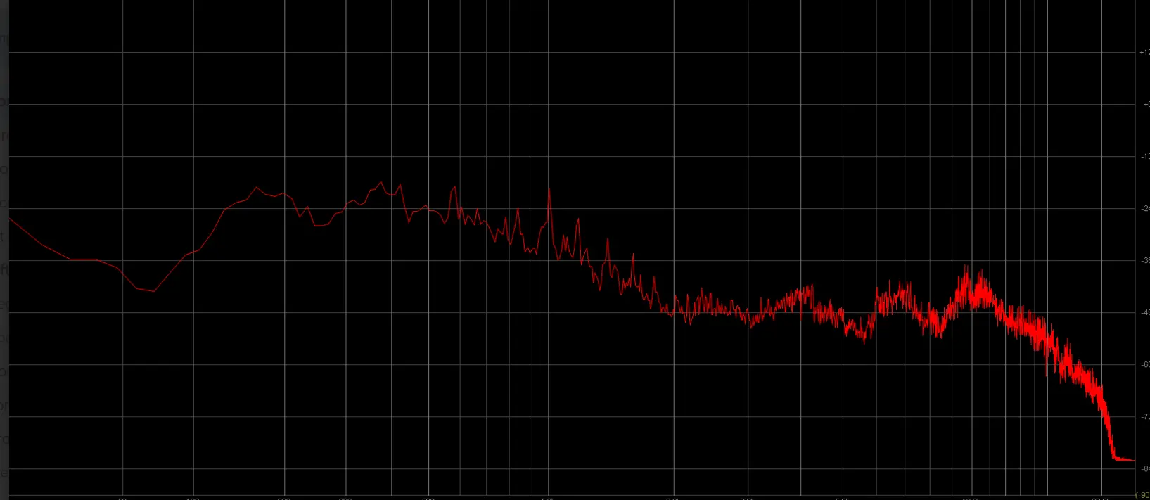

How do I get an frequency analyzer into 'Equalizer APO'? WHich good one is free and works with APO>?
What is EPO?How do I get an frequency analyzer into 'Equalizer APO'? WHich good one is free and works with APO>?
What is EPO?

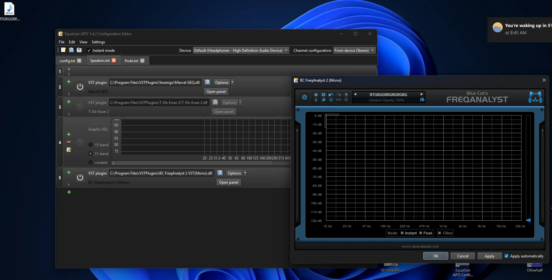

That red thing!IT PLUGGED it in but it doesnt show the curvture
Are you talking about visual analysis? An O-scope? Thats where you see the music in real time , amplitude vs. time, at a range.IT PLUGGED it in but it doesnt show the curvature

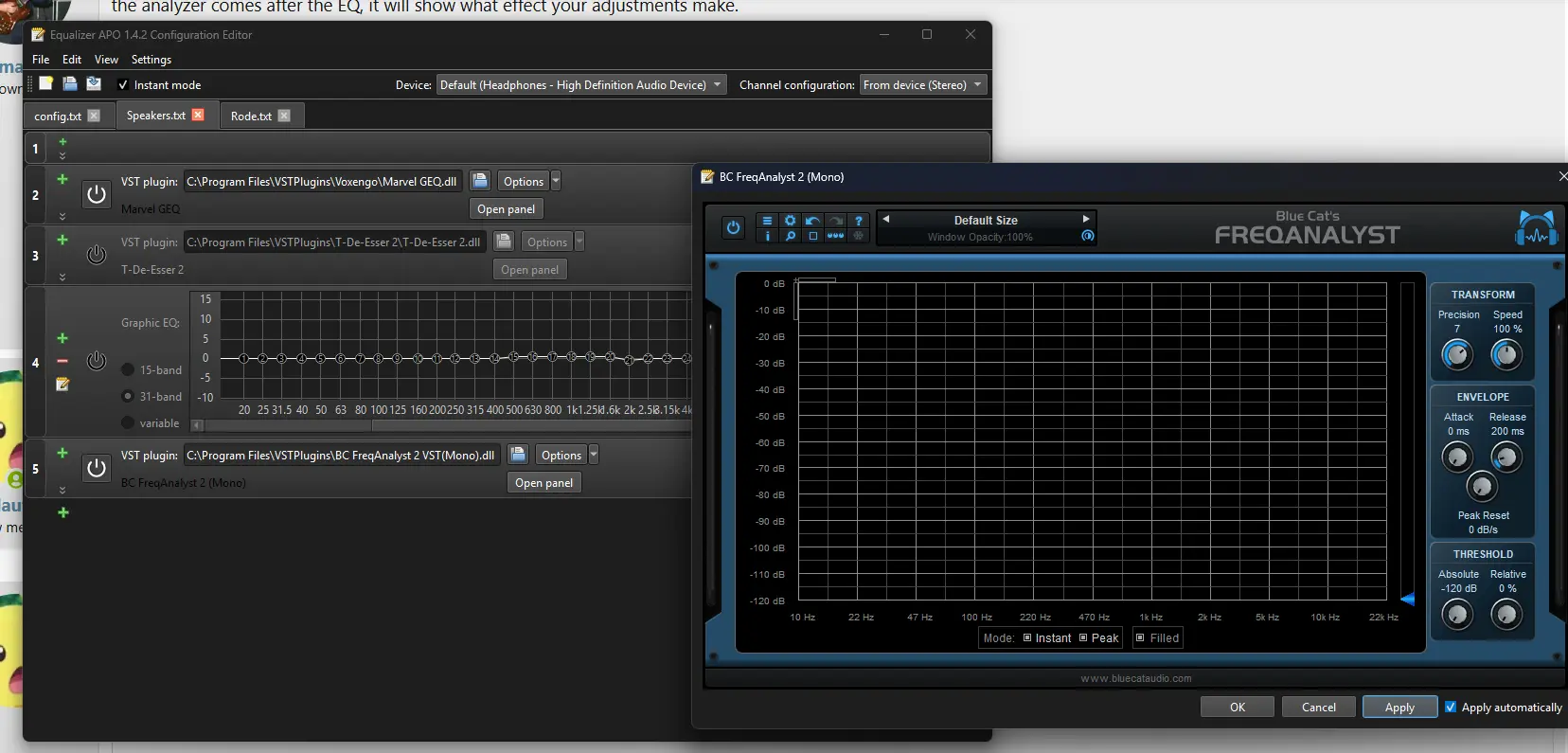

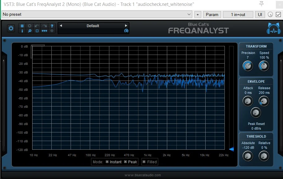

Plautus,I don't have a clue how you are using your Equalizer plugin, but if you are using a DAW, then you can put in your VST EQ plugin, then add the BlueCat Frequency Analyzer. As long at the analyzer comes after the EQ, it will show what effect your adjustments make.
If you are using it as a system adjustment tool, much like the sound enhancements in Windows,, there's no way to add anything to the program. In any event, it would have no purpose in that situation unless you are measuring sound from the speakers, as with REW with a calibrated reference microphone.
