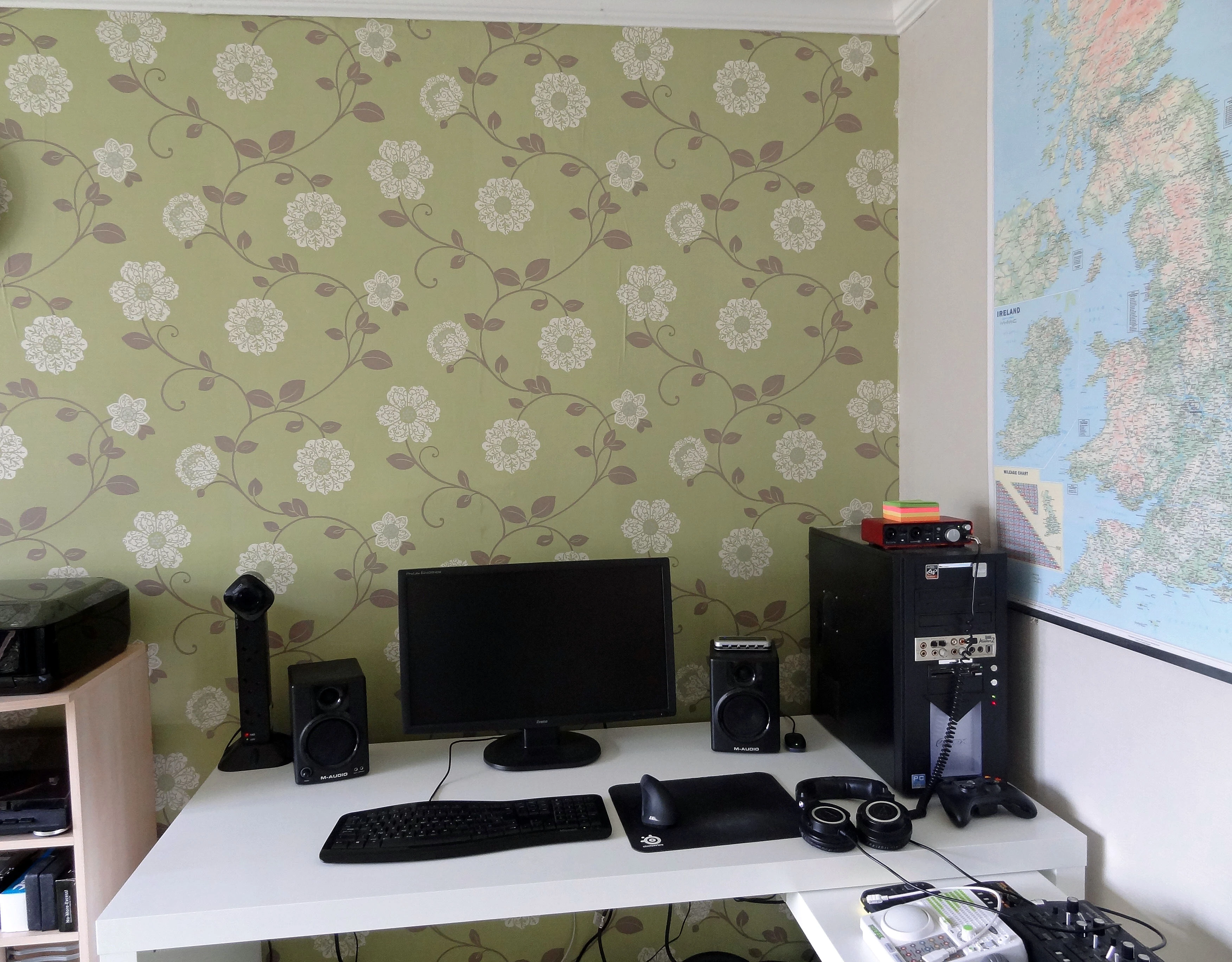

@MJB I know I really need to look into acoustic treatment but from what I've read so far, it's made me more confused and I think this is a job I can't tackle on my own. I've attached a photo of my room so you have an idea of what it looks like and where I sit. As I'll be moving soon then I am not going to do any room treatment now but may in the new house but I'm likely to have a similar setup to what I have now, in terms of space and room layout (so the PC and music stuff will be in the corner probably). I know having the computer right next to a speaker doesn't help but I don't want to put it on the floor as it's carpeted and that's not particularly good for the PC. I suppose I can move it if I need to, maybe get a small section of wood for the computer to stand on under my desk.
I think I just want to get some speakers now to have something better than my AV30's and presumably when I do move and treat the room, then that will also benefit the speakers. The JBL's are very tempting at £214 a pair but maybe I'll be better with the front-ported Focal's or something similar?
