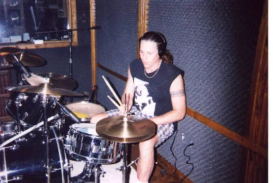

This isn't the best picture but you kind of get the idea of what I've done in my tracking room. The foam is from Markertech and is designed for studio diffusion and is on all the walls. I still have flutter echos though (if you clap your hands, it has that tubey, fluttering echo sound) and I want to do something about it. The room is 12'X16' with a 7'6" ceiling. Any guidance you can offer would be greatly appreciated.

What treatment is there on the ceiling?? At 7'6" it's the closest wall.
cheers
john
None really. It's ox board (kind of a press board that's made of big pieces) with 1/2"X 1 1/2" strips of wood spaced about 1 1/2" apart running the long way to the room. I put them up in a vane attempt to make some kind of diffusers. It's a low ceiling (it's already two sheets of 1/2" drywall and the 1/2"ox board).
Seems like you've gotr two problems then. Firstly there will be room modes at the wall distance frequencies and secondly you will have boominess created by the low frequencies reverberating cos the foam only works from around 500Hz up. I'd say you need some angled slots.
cheers
john
The foam panels are 54" square. How about if I removed the ones in the corners and replaced them with slot resonators?
Yeah across the corners is the way to go. If you look at the figures I gave sjoko you can get an idea of the slot depth, width etc etc.
