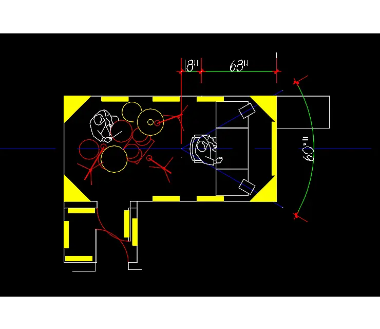

Here is what I would do. No time to explain, although I'm sure other members would have no problem.....think 703 and a vocal booth. :D
fitZ
All those yellow blocks on Rick's post are probably Bass traps, absorbers, etc... These are wall units... Check out Ethan's site, and also check out this site http://johnlsayers.com/HR/index1.htm by John Sayers. Assembling these in the right spots will allow you to control the sound in the room. Sorry if this is obvious, but you did call yourself a rookie...
jacob
Ok, got two minutes before work beckons. The yellow squares are fabric covered 2'x4' panels of 4" thick Owens Corning 703 rigid fiberglass spaced 1" off the wall. They are BROADBAND absorbers. The triangle corner units are diagonals cut from these panels and stacked in corners floor to ceiling. They are placed there because that is where LOW FREQUENCY room modes(resonances) terminate and occilate. They are "modal traps", NOT bass traps. Bass trap is a misnomer. Why would you want to remove bass from the sonic spectrum? Anyway, this stuff really works wonders. Here is a pic of the corner unit on the floor in a testing lab. Since modes collect in ALL corners, the
SUPERCHUNKS, as they are refered to, should be used at the wall/ceiling intersections as well.
fitZ

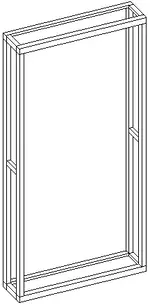

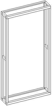

What I'd do is knock down that closet, and build an insulated stud wall with door as shown, as rick suggested(this could be used as a vocal and amp booth). Then I'd buy 8 of brians 4" bass buster acoustic cotton and 1 of his 3.5" Bulk Pack Cotton Bass Absorber packs. The 4" bass buster I'd mount in frames leaving the edges shown, like attached pic, and cover the whole thing in "breathable" fabric, then place them in the corners as shown. With the 3.5" id cut each (almost) 8' section in half and mount it the same as the 4", and use these in in the positions shown(where the middle is around ear height). With one of the 3.5", id cut it in half and either mount it in a much lighter frame, or not mount it at all, then cover in fabric. These I'd place 1 above the mixing position is the first reflection point, and one about the drumkit. That should suffice in the acoustic treatment. Now onto equipment: I've heard many good things about the presonus firepod, I'd get this, a pair of Studio projects B1s, a couple SM57s, a bass mic(AKG D112?), 3 or so tom mics(SM58s would suffice), a DI box, 4 large boom stands and 6 mini boom stands. A nice desk, i'd probs build. Possibly a behringer bcf2000 for control of what's on the screen. A nice powerful, probably dual-core processor computer. Software, I'd go with Sonar 5 Producers edition. And some decent monitors(unsure about these, too much choice). I'd also invest in 2 pairs of Closed-Type High-Performance Studio Headphones. Then a bunch of, maybe 12, XLR-XLR leads, and what else you may need. Just my .02
Everything in this suggestion could be used in another room if you decided to move, apart from the stud wall and door obviously. But this would be a decent storage area, and it helps isolate the room from the rest of the house a little.
