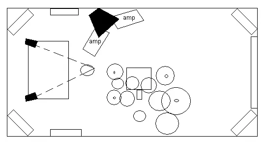

Here's a quick drawing of the studio

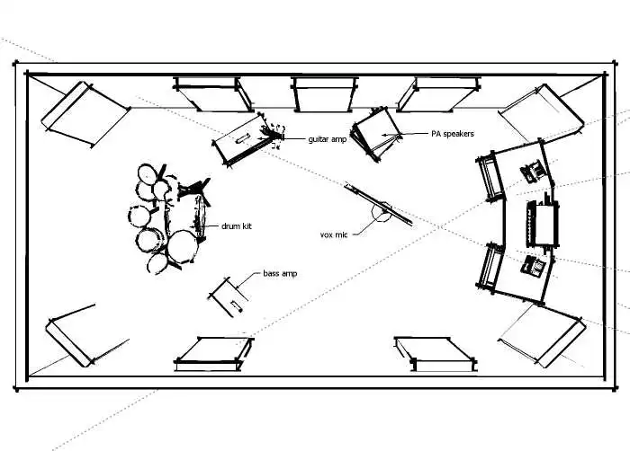

i'd put the drums all the way back and try to set up like a gig formation.

These are good ideas! I just have too much damn equipment in the room, the only problem is I have no where else in the house to put it. I like the idea of putting the sub under one of the speakers, that would save a little room. Another problem is that the drum kit is fricken huge! Here is a link to a song recorded in this room:
$8 Choke song I think it is a pretty good demo quality recording, but I want to make the best of the room I have to work with. Here's how it has been set up in the past. It seems to work okay for band practice, and recording. And of course I'm not using the PA system while recording, but during practice I use it for vocals and a little bass drum(sounds sweet with the sub ;) ) Another problem is that once we find a singer, where the hell is he gonna stand??? :eek: Again thanks for all you help and suggestions.

You don't have enough room to setup everything properly. The general rule for instrument/speaker placement is to keep them out of corners and off the center lines of the room. If you divide your room into thirds both ways the intersection of those lines would be the best places. That only gives you about 4 ideal spaces to put stuff.
I have a similiar setup and we just move stuff around to the best spots depending on what we are tracking. Gullfo's diagram would be a good setup but it looks he's cheated with the scale. Your room would need to be twice as big to pull that off.

Looks like the original setup was feedback city, sorry to say. Taper it back and you will do okay.
