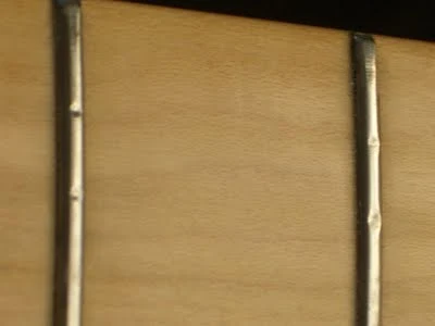

You should be able to feel when you need a fret job;
Cassie_PRSCustom24_+093.webp​

Lol. Many of the frets in my strat look just like that.
The jumbo wire means lot of fret dressings and no need to think about new frets.
That's true....but you have to really like jumbo frets for them to be a good way to go.
I don't care for them, and prefer the smaller/thinner frets....medium at worst case. The jumbo frets just feel weird to play (easier, but weird), and if you play a little harder into the strings, you get tuning issues with the added fret to neck height.
That said, with the kind of fret wear shown in your picture, you could still redress those frets even if they were something smaller than jumbo, though certainly not as many times as you could with jumbo frets.
