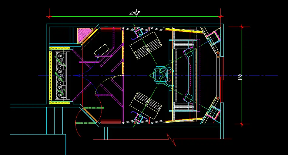

Hello Earl, thanks for the vote of confidence. I've delved into the design, construction, and acoustical areas of studio ideals for quite a time, but have never been in a position to utilize most of it. I do have my own "recording and listening" room, but have not finished it at this point. Time and money dictates the rate to which goals are attained. Ha! Which in my case is at a snails pace.:D My room is actually a nice quiet upstairs room, with my console facing a sliding glass door with a view of Oregon nature, and my house sits at the top of a hill isolated from most noise, except the occasional train and or log ship. I have yet to do any recording here, as the room is not finished, although that wouldn't stop me if the inspiration hits. It's haveing the equipment hooked up, which at this point ISN"T. :( Soon though. My studio is mostly analog(2 MSR-16's synched via a Midiizer) but I also have a Lexicon Core 32 digital system with most of the current software. But I love the analog sound.
I do have a plan though. Mostly, this is designed to make me happy with my rooms enviornment, not to satisfy acoustical perfection. I'll never get there, so gotta get happy with what I have at this point. Anyway, here is my plan.
fitZ :)

Rick,
Log ship? Now that's not something many recordists don't have to deal with! :D
The design looks great! Will be looking forward to hearing the fruits of your labors.
What genre of music do you play/record?
Thanks for sharing your design!
