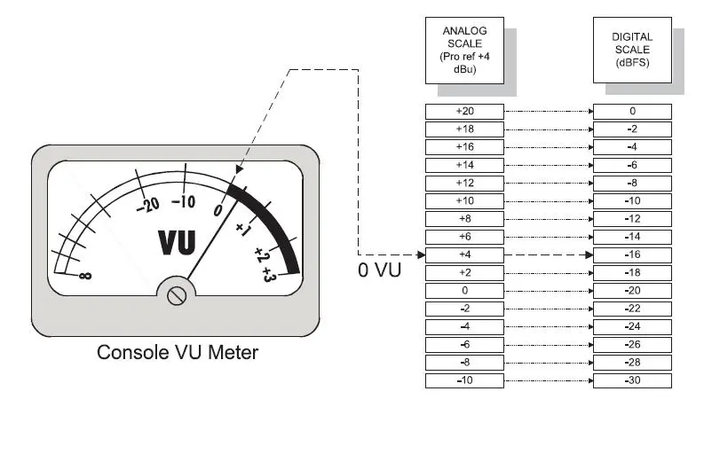

John mentioned the numbers 12 and 20 and probably meant to put a minus sign in front of the number (so it would be -12dbfs and -20 db full scale).
The bottom line is that you have tons of headroom in the digital domain below 0 dbfs, so when mixing there is no advantage to try to get your mix as hot as possible. You can save that for mastering (separately)
In the analog domain you sometimes have headroom above 0 dbvu in excess of 20 db.
Generally, if you have your converters calibrated so that -20 DBfs = 0 DBvu
this is a comparison chart of how that would look:
