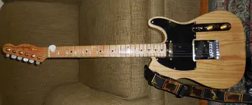

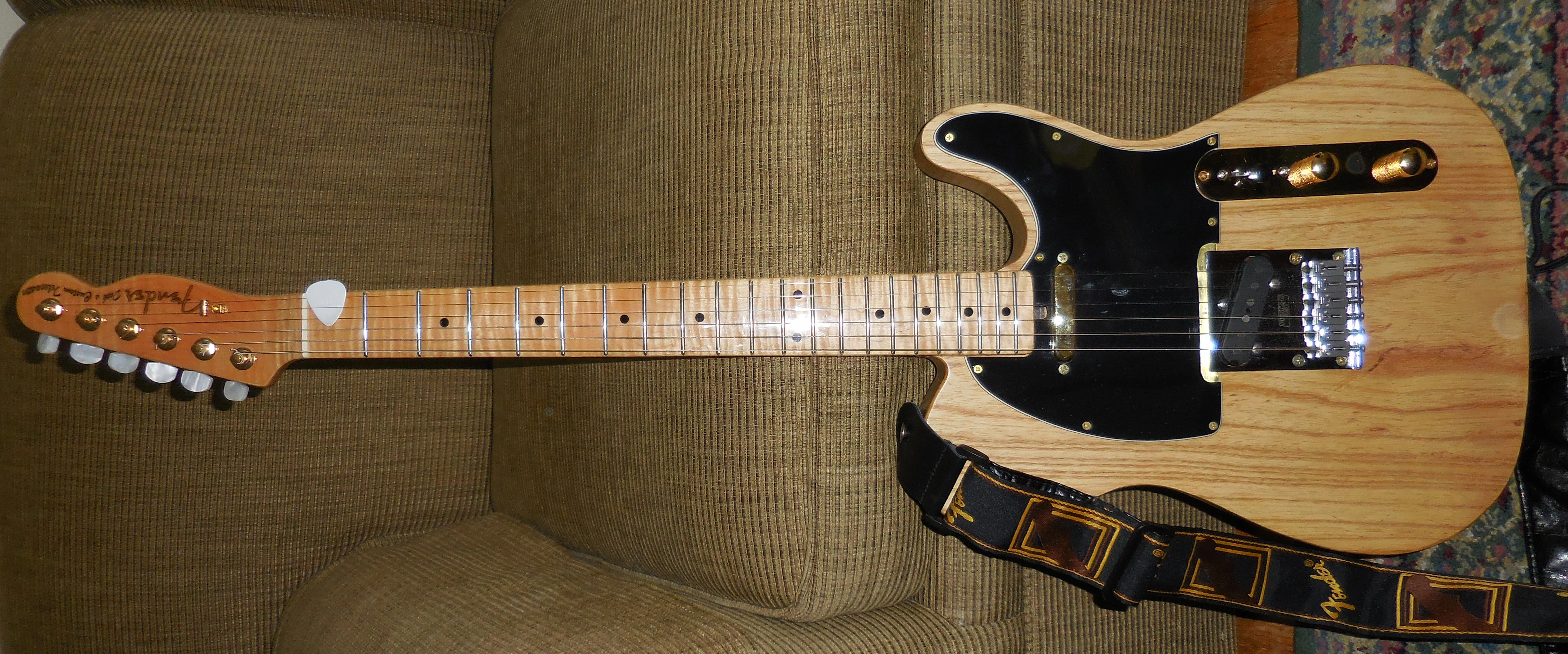

Here's my Tele in Natural
tele.webpYou've got some nice straight even grain there. I recently did the same with a Tele of great swamp ash and birdseye maple neck. I kept it natural with Acrylic lacquer and it wasn't good!!!! It turned dark where my right arm rests on the body from moisture. My grand son suggested natural waxed finish so I took it apart and sanded just the top and stained it lightly with Min wax Windsor Oak and started rubbing in old car wax Simonize. I applied it with an old T shirt and buffed with the same. It really made a nice finish with no glare in bright lights and no dark stain so far. The back is still full gloss and I think it's beautiful. ps. This tele has a Fishman acoustic bridge also and I built in a pre amp and 9V battery box in the bottom butt. I used a seperate jack (yes 2 jacks) to keep the electronics simple but can blend at the amp with 2 cords if wanted. My 1st set up was the Nashville style which is really just a Strat in a Tele body. I believe I will go back to that as it's more versatile plus the acoustic sound it gets. I LOVE IT! Good luck on your strat but hopefully you don't completely cover that nice select wood grain with paint. Shade the edges and let the grain show a little or natural & light stain. Use a crappy blank if you are going to paint it.
That is likely because you over coarted too quickly. Acrylic is a finish I wont use..

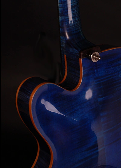

Yep, whatever I do I will pop the grain as usual with a black stain and sand back. I've done the blue thing a few times and still have one instrument for show with it so I was hoping to do a different colour. I don't get to do a lot of bold colour finishes as most people want the natural wood look which is cool I guess.
Here's the blue. on the archtop I still have. Did it quite a few years back but still have the guitar as it was a side by side build like this one..........Remember when blue was the thing....?....:o
