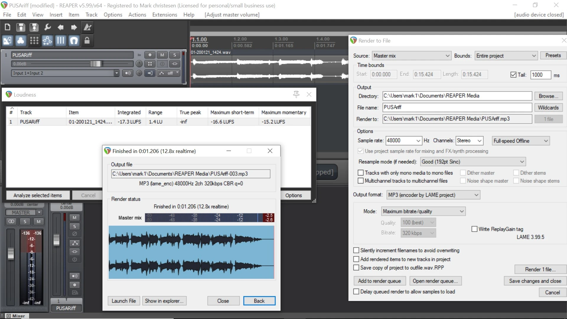

Reaper. I am playing it with Reaper. In the same environment as the multi wav track mix. I am using the Loudness function from the 'Action' tab to normalize POST #17 has the picture of what that looks like. I analyze the 'Loudness' of the multi track master, it will say -14 LUFs. I will Render as MP3 and drag the file back into Reaper. Analyze that rendered MP3 and it will be -10 db lower in level. If I gain it back with the main slider it sounds echo'd and bouncey.

I am playing it with Reaper same ASIO. In the same environment as the multi wav track mix. I am using the Loudness function from the 'Action' tab . I analyze the 'Loudness' of the multi track master, it will say -14 LUFs. I will Render as MP3 and drag the file back into Reaper. Analyze that rendered MP3 and it will be -10 db lower in level. If I gain it back with the main slider it sounds echo'd and bouncey.

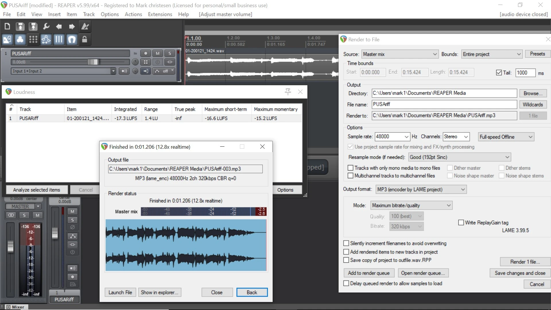

For what it's worth.........my sample rate is set at 44100 and I use Constant bitrate (CBR)mode. I have never changed those settings. Otherwise......my settings are the same as yours.
The finished render is showing -2.5 peaks. The peaks in mix of the tracked wav's is analyzed at -15.2db in Lufs. Are these not supposed to be the same peak value at unity, master fader set at 0?
