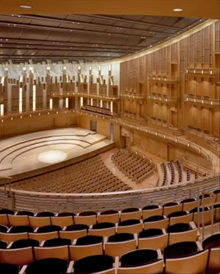

Make it shaped like this:
BTW that's the Strathmore concert hall in Bethesda Maryland. Everything sounds incredible in there. The room actually gets larger in every dimension as you get further away from the stage. There are no paralllel walls. The ceiling is one giant diffusor. The walls alternate traps and wood. The doors are supremely heavy. There is lots of wood but not so much that the room over colors everything. I've been in a concert hall where I heard 20 different classical guitarists play and they all appeared to have the same tone because the room was dominating too much.
