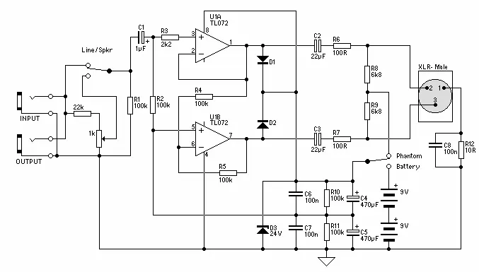

You could also build a DI Box for Pocket Change(Under $10) if you are electricly Inclined??

Yeah, if you don't need tranformer isolation, or don't care about the quality of sound above say 8khz, you could.

You don"t need a Transformer to Change the output Impedances, You can use a Basic Fet Impedance Buffer to Convert the High Impedance Source to a Low impedance output without affecting the Frequency responce and only introduceing maybe 3db of noise depending on the Fets used....
Many DI Boxes are Much too small to Fit a Output transformer in as well as the Circuit Board so many DI Boxes use a Fet Buffer or Opamp to change output impedances.....
Sort of like this:
Cheers
