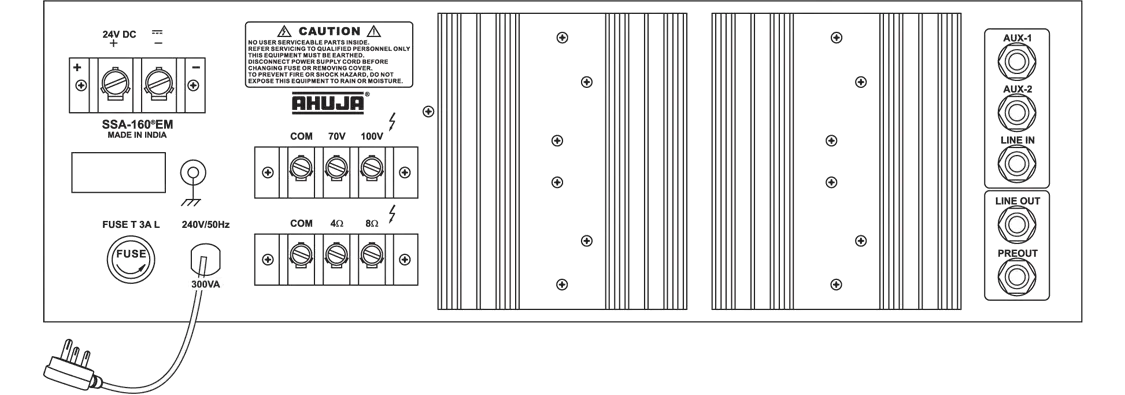

Maybe rix55 could state the manufacturer and model number for the power amplifier? Or at least a picture of the back of the unit (assuming that's where the "Line output" resides).

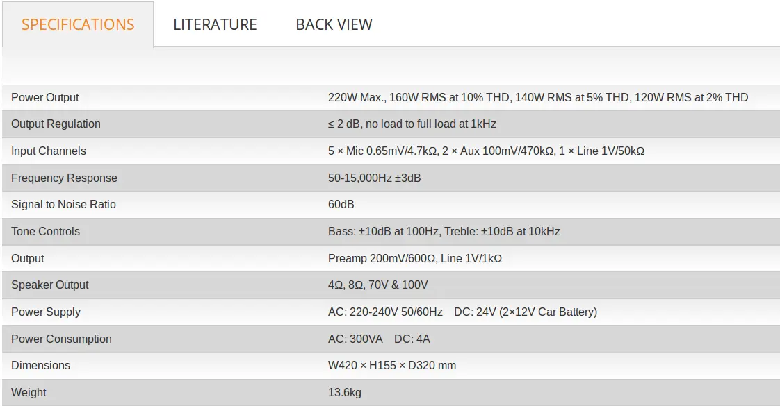

Hi arcaxis & gecko, I have attached the PA manual's back picture illustration (could not find a real pic on the net). Also, a front pic and its specs included.

The PA has a line output. The manual doesn't specify whether it is a TS or TRS socket. MY guess is that it is a mono TS output.

Aha! The line out is specified as 1V/1k and so might overload the input of the recorder. I see there is another output, "pre amp out". This is at the much more useful 200mV but I suspect is wired as an "insert" and plugging in a TRS jack will stop the feed to the PA (probably intended for use with an EQ or other feedback control system) .
The fix is easy, just link tip and ring in the jack lead but involves some soldering.

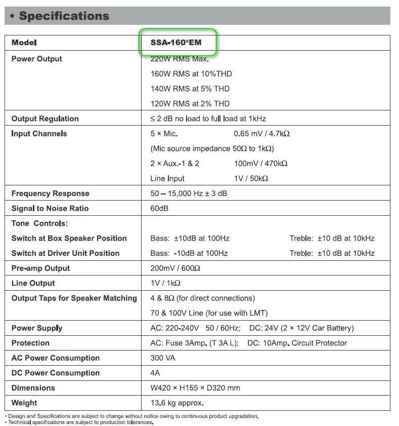

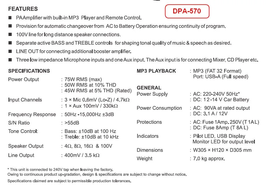

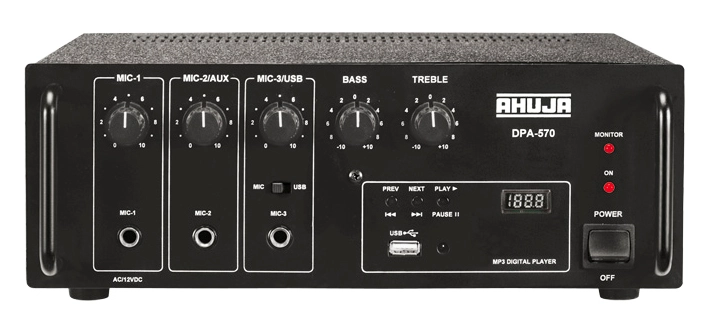

Not sure if rix55 has his models mixed up in the images. The specs and back view seem to be for the SSA-160EM, but the front image is a DPA-570. They do have different levels on the Line out jack and the DPA-570 does not have a Preamp Out jack.
rix55, could you clarify which PA you actually have?

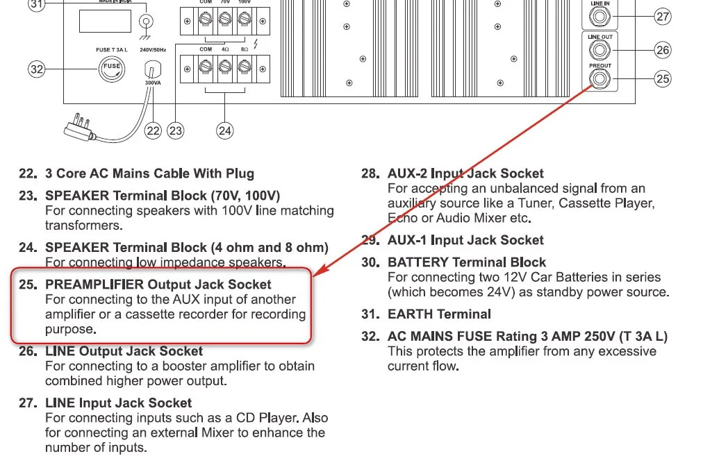

If the PA is indeed the SSA-160EM.........
Hi Mark... you are right, the front view of the PA is not of the SSA-160M. I could not get the exact model - but took one off the net that looked the closest. But, the manuals are of SSA-160M (which we actually have). I never knew you could say a lot about a device by just its front image. Thanks for clarifying, Mark. I am going to try the Zoom H1.
