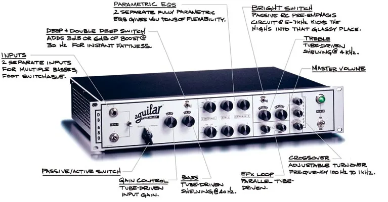

Thanks for all the feedback. It's interesting to see what everyone uses. I myself use a Aguilar DB680. It has five tubes and a parmametric EQ. I like it cause you can plug straight into your sound card and hit record. I get a pretty fat and juicy sound but sometimes its hard to get it to stand out in the mix. I dont know why, I think a lot of it has to do with my shitty mixing skills.
I've also been thinking about checking out a U5.
