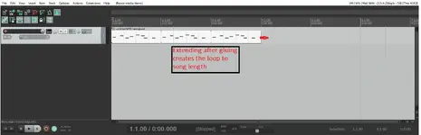

Step entering drum parts in the piano roll editor until I got a section that could be repeated to the end of the song, I then wanted to extend that sequence from, say, measure 4 to measure 140. So for me, the fastest way I found is to select the MIDI item in the track screen and Glue it. Then in Item Properties, enter the desired length and Apply/OK - voila!

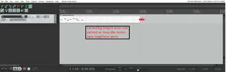

If you don't Glue the item it will still extend to the desired length but will not repeat the sequence as a loop. You'll wind up with a lot of empty space after the initial sequence.

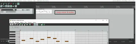

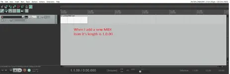

Add a new MIDI item. Open it's editor. Step-enter 8 notes.
Drag the item out and it will be empty except for those 8 notes.

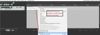

Drag it back. Glue that item, then drag it out again.

If you want to actually remove that hidden part so that the item is actually only as long as what you’ve split/slipped it to, kind of the quickest way to do that is to glue it. Now it’s a new item that is only as long as what was visible from the original and you can loop it all you’d like.
Yeah.. that's basically what I'm doing only I begin with the shortened item (default item as added initially).
Here's my process :

Oh that actually is a little weird. Does that original item have “loop source” checked in item properties? That should do it without having to glue, but again only if that item is actually that long. I can’t imagine how it could be longer if it was created that long, but I also can’t figure out why “loop source” would be off when it’s first created but then on after glue. There are default settings for that, but I’d think it would apply to all newly created items no matter how they are created. Unless something in the step record process turns that off?!?

...but I also can’t figure out why “loop source” would be off when it’s first created but then on after glue. There are default settings for that...
Loop was on in Item Properties, but..
I went into Project Settings and discovered "Loop Source" was off there. Turning that on did the trick, as you say, it now automatically loops when first added to the track - no gluing required.
I would have sworn that was on previously. Perhaps the Reaper 6 update flipped it off.
