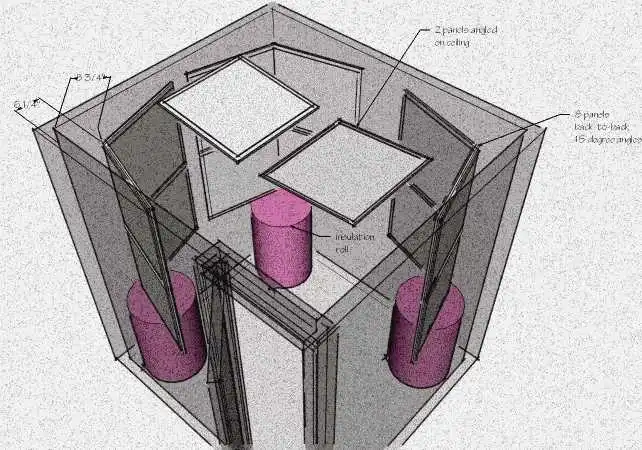

or even use them back-to-back and glue around the edges. then take 2 sets of those and make a 2'x4' unit which you can then hang a couple of inches off the wall. here's a small booth concept. using rolls of insulation (still in plastic) in the corners.
Why the insulation in the plastic? To help with sound deadening? I like the idea of putting the tiles back to back and placing them a few inches from the wall, that gives you two absorption surfaces. I think I might go ahead and use these, like I said they are 10 cents a piece at the local used construction materials store. I will definitely wrap them in some kind of thin fabric though.
