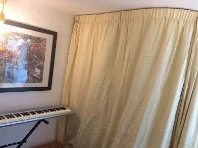

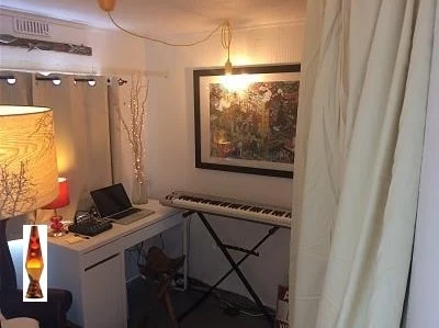

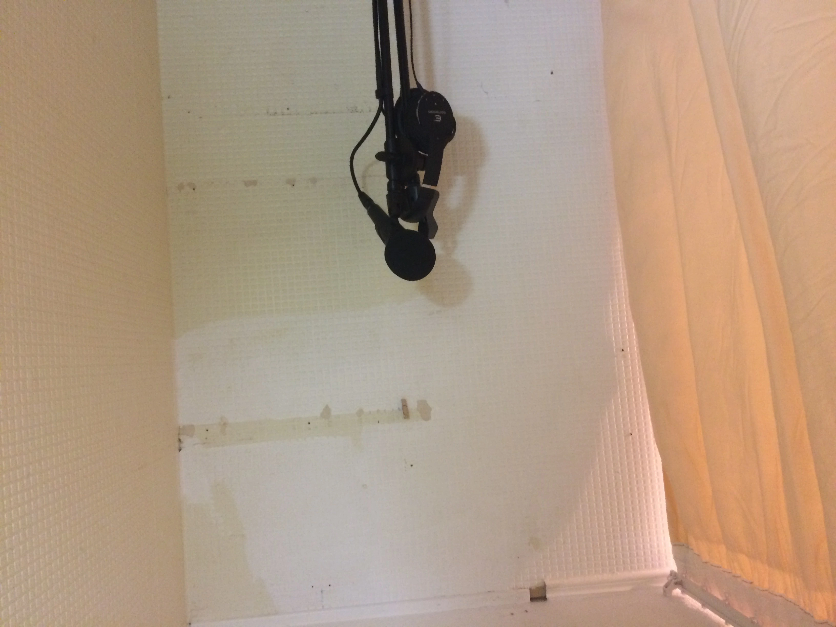

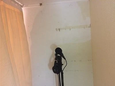

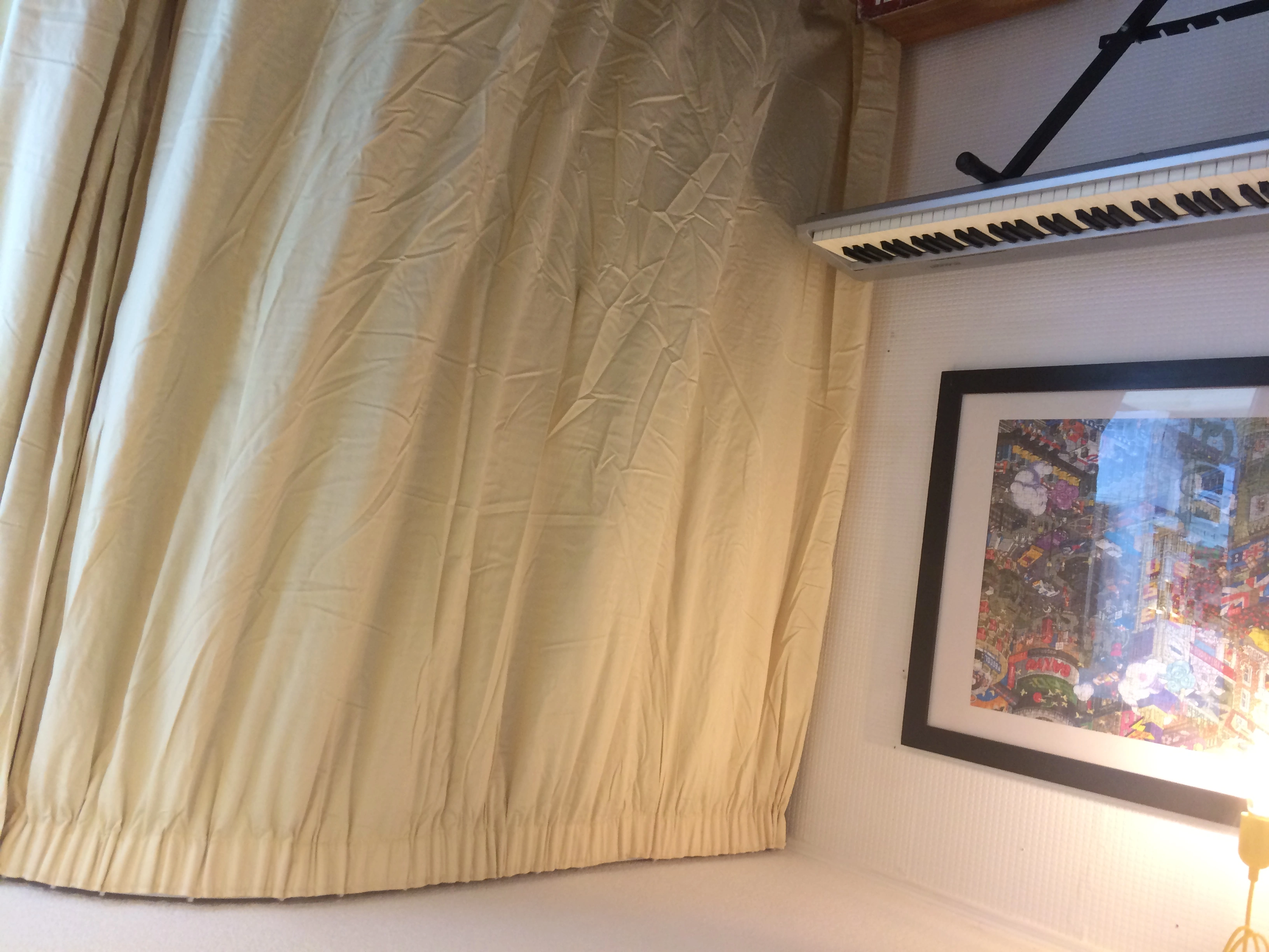

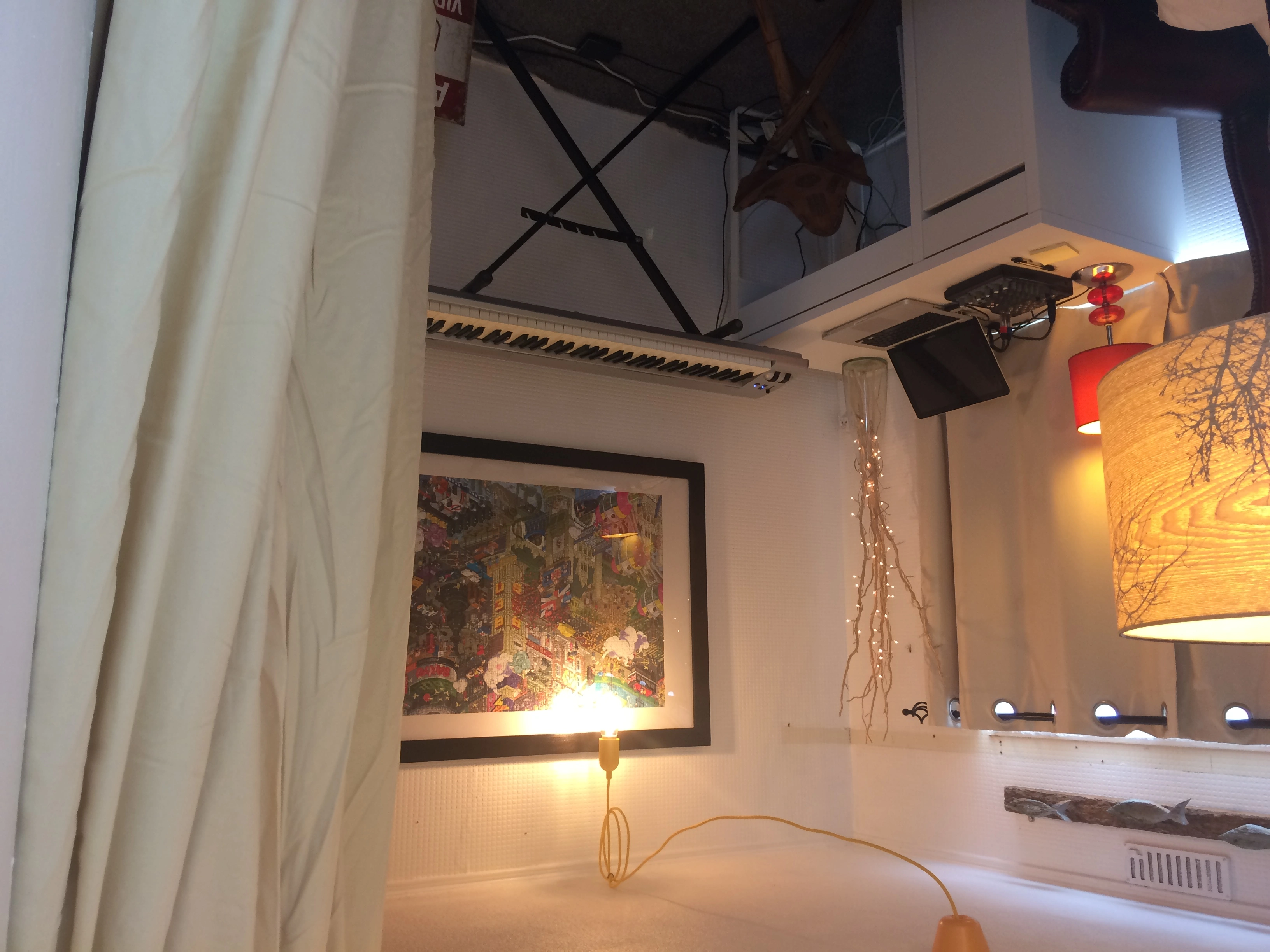

I'm an amateur singer/songwriter. I have no intention of producing anything professionally, and I can't afford to invest in professional equipment to kit out my home studio. Currently I've created an area for recording vocals by hanging a curtain floor to ceiling across a corner of my studio. The curtain is lined with foam wadding and does a nice job of absorbing sound and deadening the reverberation in the booth area. I would like to add acoustic treatment to the walls and ceiling of this area to prevent as much sound reflection as possible. As I said I cannot afford to invest in professional-level materials. I have found on Amazon the following foam tiles, and I'm wondering if they would do the job:
http://amzn.eu/cN098HC
http://amzn.eu/dqfTzEs
They have good reviews, but I would like to hear opinions from people who have used them in building a home studio setup. Also, should the tiles go all the way from floor to ceiling, or do they only need to be at the level of the microphone?
I have attached some photos of my studio to give an idea of the space and layout currently.
Thanks in advance!
Edit - no idea why the photos are upside down... they weren't that way before I uploaded them!

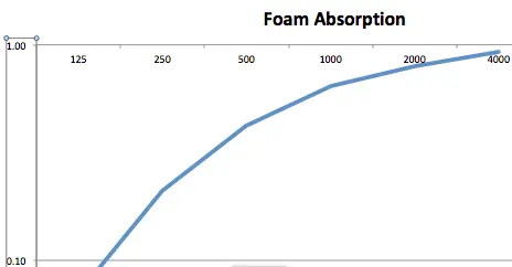

The real problem with foam tiles is that they do not really minimize lower frequency reflections. The details on the one link had this:
Below is the Foams Random Incidence Sound Absorption (Typical Results) Frequency (hz) to Relative Absorption Coefficient
125Hz 0.07
250Hz 0.21
500Hz 0.42
1000Hz 0.64
2000Hz 0.80
4000Hz 0.93
So, you can see that it falls off pretty sharply in the lower frequencies, but the fundamental of the human voice is pretty much entirely in that below 500hz range. So, while you'll notice a definite reduction in HF sound, it's not going to do an awful lot for your baritones and basses. Is it better than nothing, sure, but it's not a suitable substitute for real treatment, and it won't help at all if you are mixing instruments with stronger lower fundamental content, like guitars, basses and drums.
