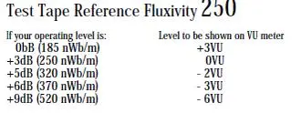

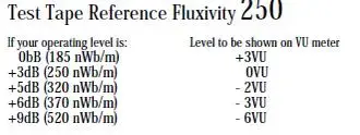

The voltage output should be +4dBu (1.23v) no matter what the operating level of the tape is, just that 0VU is 520 nW/m (+9dB) instead of 200nW/m (+1dB or so) I don't have a chart for a 200nW/m tape, here is one for 250nW/m, which is per this http://www.digido.com/quickfaq/n/nano-nano-what-is-this-+9-business.html?format=pdf 2dB higher than 200. So the math should be -8VU for +9 or -5VU for +6 taking into account the difference.
See e.g.
