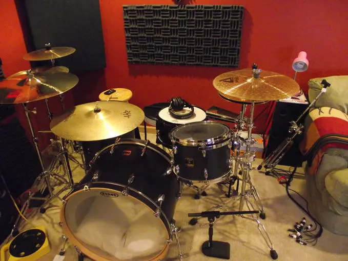

Thanks so much Re-tox for the help! I am definatley a guitar player first and a recorder second but I'm wanting to change that and I really enjoy messing with the technical side so hopefully I can become alot better. I was wondering if you didn't mind posting another link of your vertical bass traps, the link that u posted didnt' work for me. and thank you guys alot I am loving this website and plan on bugging you guys daily :P.
DSCF2296.webpThat was just a picture I found on google, but here is on of the pictures from my setup. My traps are only 4'x2'x4", but they get the job done. Also I realize that this is really just a picture of my drum kit, but you can see enough of the trap to get the picture :)
