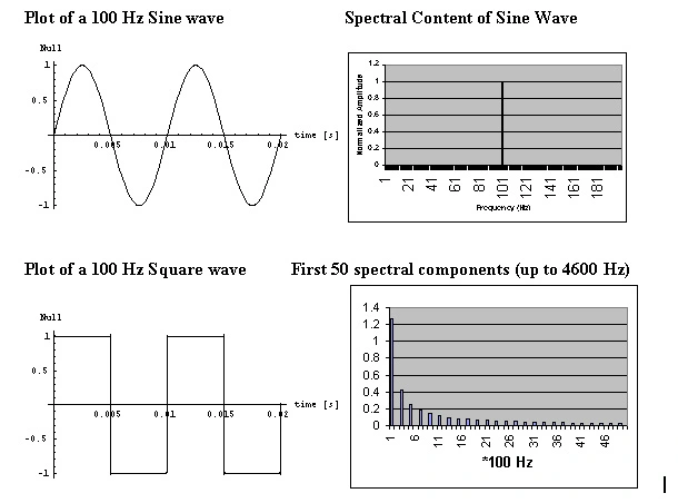

Understanding things like Sine Waves and Square waves, harmonics and overtones might be a little more advanced . . . and I could certainly use some brushing up on that stuff as that's easily my weak area. I hate to admit this, but I don't know a sine from a square from an octagon wave. :D
Sine wave is a single frequency. Square wave is made of odd multiples off the fundamental frequency with decreasing amplitude.
See the attachment for a visual. The plots on the left are what you would see if you zoomed in on the waveform view. Plots on the right are what you would see in a frequency analysis/spectral view. On the bottom right plot you need to multiply the x-axis numbers by 100 as they are plotted as mulitples of the 100 Hz fundamental frequency.
