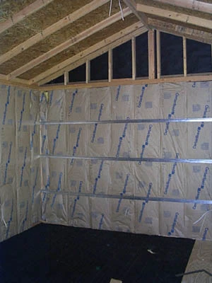

Okay I have pictures now....Here's resilient channeling....

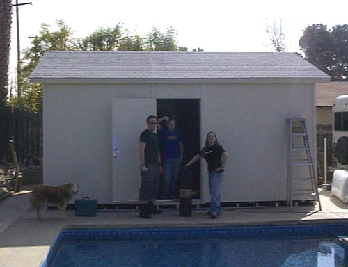

I'll just put some more up incase anyone wants to see....
This is the outside..it's essentially a "shed" because it's not built into the ground it's just ontop of it. We hired a contractor to build the external structure and other than not into the ground it's just built like a house (i guess)

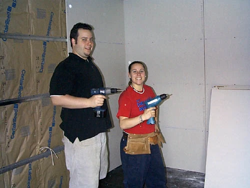

I'm in the black shirt, we're just hanging drywall.
We did the drywall on the ceiling yesterday, and if home depot didn't rent panel lifts it would have been a pain! ($25 for 24 hours....a lifesaver!)

One thing puzzling me is why you didn't just mount the construction on floats, sit it in the pool and have terrific isolation from ground/floor vibrations. Just imagine the guys wanting to book time in "The Studio Afloat":D
:cool:
good idea! Maybe it's not too late. I'll get a crane and have it mooved. :)
Floating studio (must not suffer from sea sickness) $1000 a day. :)
Well obvoiusly you are not the one in the red shirt.......else you wouldn't have asked all the questions ;););) just joking :D
looking great - that's resilient channels !!!!......... in fact the second pic shows it even better but we are distracted by Butch Cassidy and the Sundance Kid armed with their weapons :D:D

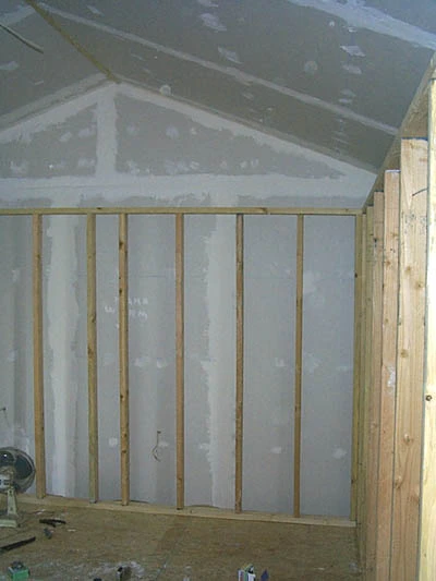

ok well we figured out the floor and put it all together yesterday...It came together VERY well.....easy to do, seems like it's just the right amount of "spring" in it. I didn't buy the pads from soundproofing.org, I found a place by me w/ 3/4" neoprene (60 duronmeter) for about $60 to make pads for the whole floor, 14x18...
Anyway we did the inner frame today. You can see the frame and a bit of the floor attached. It's too bad I didn't think to take pictures of the floor before the osb plywood was on it, because I know seeing it before we did ours would have helped me. We have one picture on reg film, not developed yet....i'll post it when I get it.

It's a 2x4 frame with fiberglass in that cavity as well. There's 5/8 sheet rock on the inside (room side) of that frame, but not on the outside (air cavity). This is very different from John's design, and in an ideal situation, I would have followed it, but it just didn't work out that way.
The room was built as a 14x18 room, and we were going to leave about a 2-3 inch airspace, but when we started measuring, we choose to leave a bigger gap of about 7-8 inches, because that made the inner room 12x16.....much easier to work with as plywood and drywall panels are 4x8 and fit evenly. The extra inches are valuble real estate, but oh well. 12x16 is big enough to practice in.
