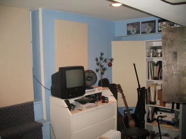

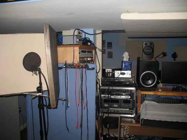

Thanks for all the kind words. I think I like the V shaped unit I made more than this one. Maybe part of the issue of difference in sound is I have about 14 703 panels in my room to begin with. Also the position of where I record vocals is right in front of my cubicle panels. So the room is pretty tame to begin with. These panels just make it even better. The recording I did was with a TnC 1200 mic. I did that because I have the mic out to be modded so I wanted a recording to A/B. The mic was set up pretty straight ahead. I really should have done the sample in a crappy sounding room. I think you would have heard a bigger difference. Anyway I'm adding a couple of pictures to show the position of where I recorded.

That's gotta be why I couldn't hear more of a difference. I felt the one without the trap sounded pretty good to begin with.

This is going to sound really dumb, but after looking at your pictures and ethans, I still dont understand how it rests on the microphone stand.
Could you explain or maybe post a picture?

Take a look at post #5. That's the mounting bracket. I purchased a stock piece of aluminum with the holes already in it from Home Depot. I used a large drill bit to widen the hole. The aluminum bar went over the threaded center of the mic stand. I used the bottom section of a mic clip to hold it in place. I then bent the aluminum bar by hand to fit the trap.
