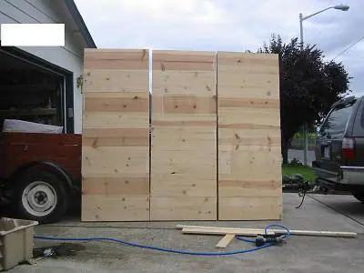

Here is the "supply list"
2X4 frame
1/4" plywood or ??? (I used pine that I got free)
Some R-13 Insulation batts (I bought 2 rolls - my panels are 32" X 7')
3 $2.97 twin sheets from Walmart
4 eye bolts
4 "Gate hinges"
1-2 tubes of liquid nails
Crap - I guess I don't have pics. Here is the panels from the back -
The other post shows the hinges.
I just glued the insulation (kraft faced) with liquid nails to the wood. Then folded and stapled the sheets over the front.
The actually do a pretty god job of knocking the reflections down. I have a 24 X 32 room with hardwood floors, and it's REALLY reflective.
