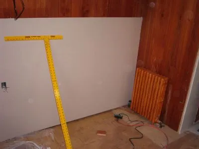

436 - the beginning of sheetrocking the sofa cove, and you can see the radiator I asked about earlier. It leans on the wall, of course.

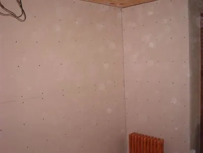

437 - back wall and radiator wall sheetrocked.

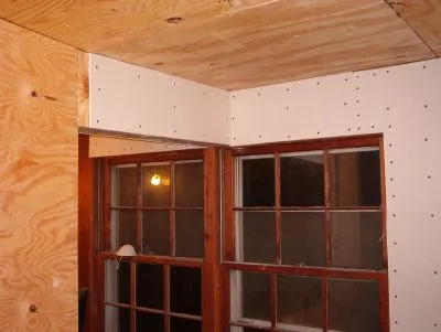

439 - working around the doorway to the vocal booth.
Yes, thats a window in my vocal booth. I haven't figured out the treatments yet, or whether to use a shudder, or something along those lines. I was smart when I built the booth wall that its inline with the rightmost window of the pair, so that the vocal booth door will line up with the wood between the windows, unlike last time, where there was a friggen 2" gap I couldn't seal up right.

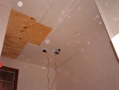

441 - this is the sofa cove ceiling, and the dormer ceiling, and the skinny vertical triangular piece in between. The sofa cove ceiling is at a 2 degree angle, the dormer ceiling (to the left, wood showing) is a 6.5-8 degree angle depending where you are measuring. This is partly why there are a lot of little pieces of sheet rock up there. Bending a large piece resulted in fragmented, wasted sheet rock. Thought I was able to do that in front of the vocal booth wall over the producers desk as well as inside the vocal booth ceiling, amazingly enough. Maybe I was tired when i was at this part of the ceiling and just didn't do it right.

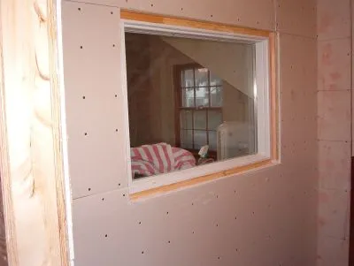

442 - vocal booth window, inside.
Nice, neat seams, hand cut using a sheet rock saw and a straight edge. I'm just proud that something came out right, so enjoy the photo :)

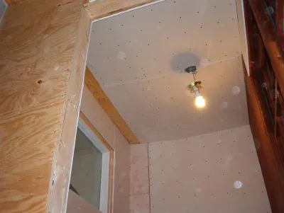

443 - lying on the floor, looking up at the vocal booth ceiling. Like the rest of my ceiling it has a lot of weird angles and things never line up, but here, somehow, magically, I managed to get the sheet rock to curve nicely across the 2 degree, 4 degree, 7 degree angles that are part of the booth ceiling. A little rasping here, a little planing there, a lot of belt sanding, then screw up the sheet rock.
I don't think it buys me anything acoustically, but its visually pleasing standing in it. Makes the room feel slightly larger.

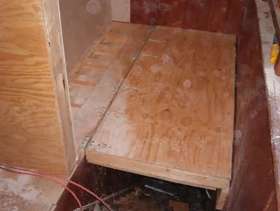

444 - vocal booth flip floor in the down position. I've mentioned this several times when people were looking for a way of taking advantage of every possible space, and here was my solution. Overlap the vocal booth over the stairwell, and creating a floor section thats hinged so it can be flipped up and into the part of the booth thats not over the stairwell.
I just think its a cool feature. The stairwell leads to the outside, so my studio has its own entrance if I flip the floor up.

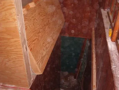

445 - Flip floor up, demonstrating its operation. Very simple.
Believe it or not, I can get my 4x12 cabinet up and down the stairs with the 2x8 sill on the right (which is connected to the 2x12 house framing on 16" centers using two lag bolts per stud), and the 6" overhang of the floor.
Its impossible to see from this angle, but I routed out the left edge of the stairwell in this picture, and six of the eight 2x4's inside the flip floor sink into the left side wall. This way, if people are standing on it, and the hinges snap, the floor will drop about 1/8" on the left side. Of course it can't be flipped up any longer, but at least people, gear, and beer won't fall through down the stairs and create an insurance liability.
I've already had 242U worth of gear in there, plus my ampeg 4x12 cabinet (which is not light), a bass amp, my fender cybertwin, my 150lb drill press, and many boxes of cables while i was redoing the rest of the room. Not sure what that weighs, but its a hella-va lot more than 800lbs.

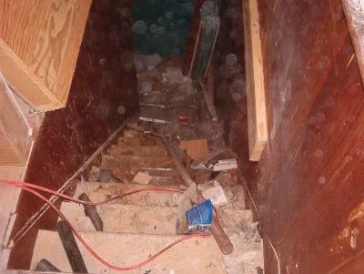

446 - the other "construction debris depository". I tossed all the burnable stuff out the window to be cut up (which most of it has at this point) and all the "other" stuff down the stairs. I learned the hard way, using "contractor bags" which hold about 60 gallons of trash, are absolutely impossible to get out the 18" doorway I have, so I figured I'd just toss it down the stairs, and clean it out this weekend from the outside door.
A lazy way of doing it, but it works. I had my miter saw on the edge of the flip-floor for a few weeks, so there is probably 100lbs of sawdust litering the stairwell. Eeeeeek.

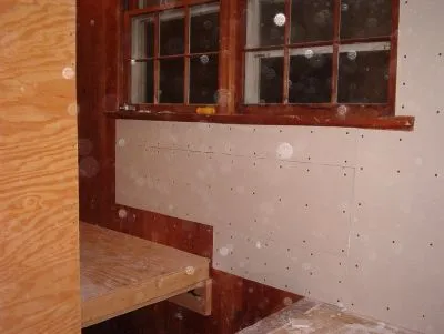

447 - more boring sheet rocking photos, under the windows.

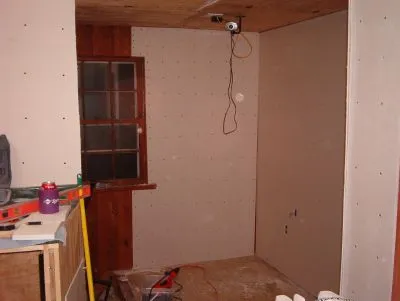

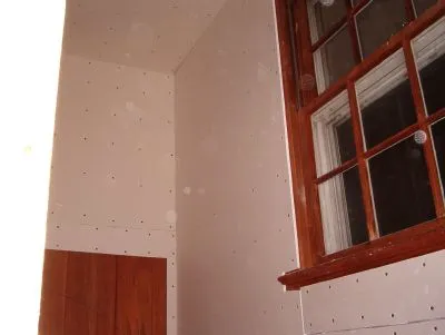

448 - last wall inside the vocal booth.
at the lower left you'll see a little of the cedar paneling. Unfortunately, its going to have to stay exposed. I'm going to find a nice wood putty at home depot, and fill the termite holes, prime and paint it with oil-based paint like the rest of the booth. I wanted to sheet rock it, however the flip floor is so close to the cedar I can barely get a 1/8" metal strip in there, so 3/8" sheetrock is out of the question. Since thats knee height and lower, I'm hoping its not a big deal. I still have to figure out the acoustical treatments in the booth, and I'm thinking angled panels might be a good choice, since whisper room booths are darn nice, and have this type of configuration. I'd just have to figure out the material.
