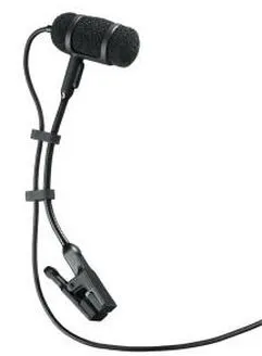

3: or a mike with a different style of clamp like a ATM350 atm350_1g.webp

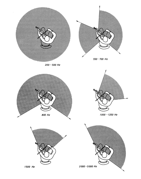

It does help to understand how the violin radiates sound at different frequencies.
See below:-
Oh - I would always avoid "sound holes".
