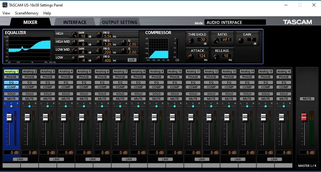

Surprisingly, the Tascam 16x08 has just such a feature. There is EQ and compression (no gate feature) in the interface itself. It shows up in the driver/interface screen. Attached is a screenshot of the interface with EQ and compressor. It will effect the recorded sound into your DAW like Reaper or Cubase.
The lower input versions don't have the same feature. I think its only available with the US16x08.

Are the comp/eq's hardware or software? The website isn't clear, it just says "DSP mixer"
Its a built in Analog Devices BlackFin DSP processor in the mixer itself. It takes no load from the computer.

EVERY USB audio interface will require a driver (most likely ASIO). With the Tascam, the driver software also sets the EQ and Compressor setting in the interface, taking the load off the CPU.
