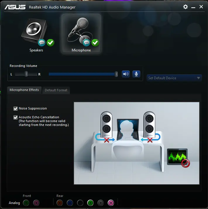

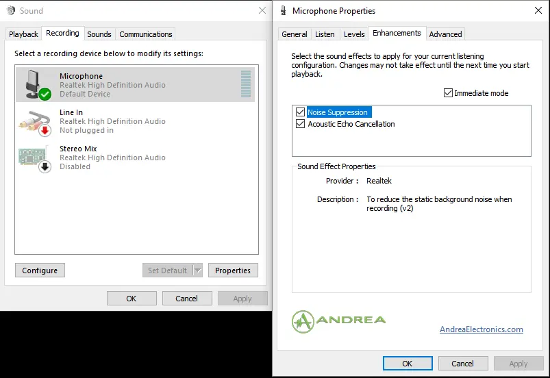

Both my headset mic and my Vanker desktop mic won't record my voice at a steady volume, making it difficult for my friends to hear me on voice chat because it sounds like I keep getting cut off. I've tried enabling and disabling noise suppression and acoustic noise cancellation, and upping my mic boost from 0 to +30, and nothing changes at all. I've also recorded myself in Audacity to study the wave lines, and even they are very unstable, despite me making one continuous monotonous noise. My audio engine is Realtek HD I believe, and I am running Windows 10 64-bit. If anyone needs anymore information, just ask. Thanks!

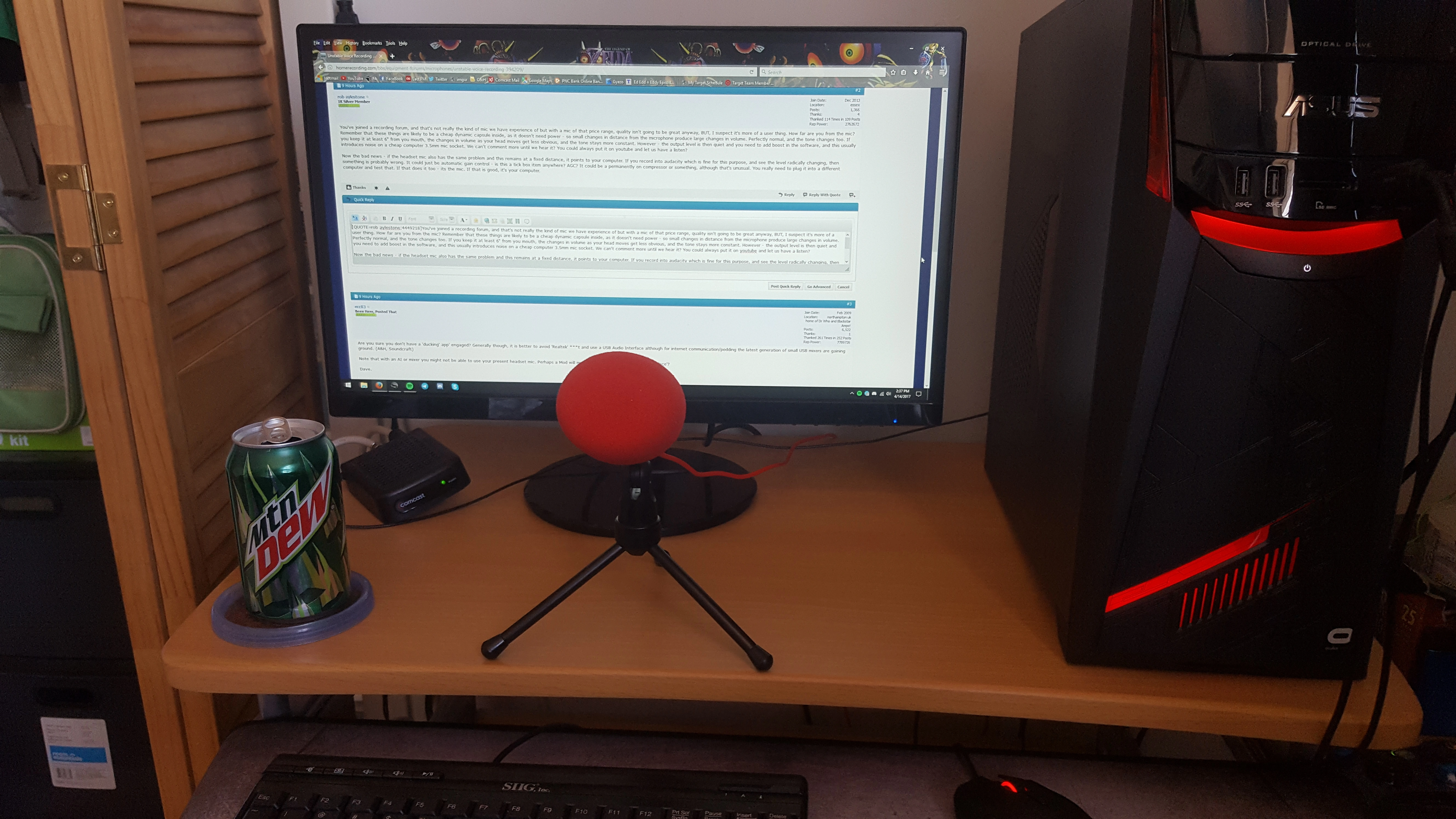

This is about the distance, from the perspective of my mouth; it's about arm's length from me. However the distance is not an issue, as it still does that 'auto gain control' that you spoke of, regardless if the mic is even literally physically touching my lips or on my desk on its tripod.
I also neglected to mention that this issue is present even in its most raw form, which is listening to live playback through the Windows audio control panel. I have no other apps or whatever going on that could interfere, at least as far as I know, other than a Realtek HD exclusive control panel, aside from the one that Windows uses. Could that be a problem? I just have my mic plugged in at the back of my computer in the pink jack, and that's really about it.

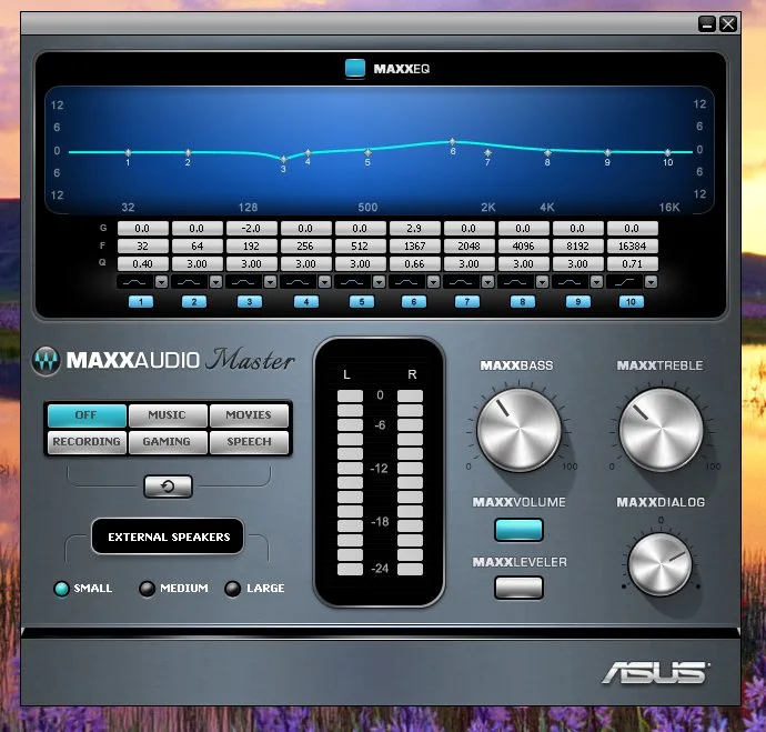

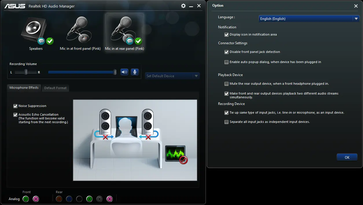

I've got an ASUS PC, Win10, and a Realtek soundcard. Besides the Windows and Realtek controls for the sound, there is an ASUS control panel that does some stuff on playback of audio. I don't know if it messes with recordings or not. It took me a while to become aware of the ASUS controls when I first got the computer. Two of the settings could possibly give 'fluctuating' audio. MAXX Leveler (compression sort of thingy) and MAXX Dialog (not sure what this actually does, but seems to cancel L/R leaving whatever is centered(?)). I usually just keep this control panel set to off. Perhaps in your PC there is something hidden like this.
Nope I don't believe I have that; I just did a search through the Windows start menu and I didn't get anything from Maxxeq.

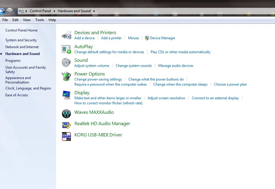

Take a peek in the 'Control Panel > Hardware and Sound' and see if you might have something audio related besides the Realtek Audi Manager. Might not be MAXXEQ as this is something that's ASUS branded.

Nothing like that, but I do have this, which I mentioned earlier; it pretty much works the same as the Windows audio panel.

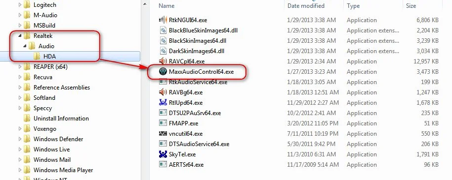

I had no idea where the MAXX file was so I looked for it and found it in 'Programs > Realtek' folder. You may not have this wonderful ASUS 'feature'.
I have it, but it's an '.msi' file, and it says it's not supported or whatever.

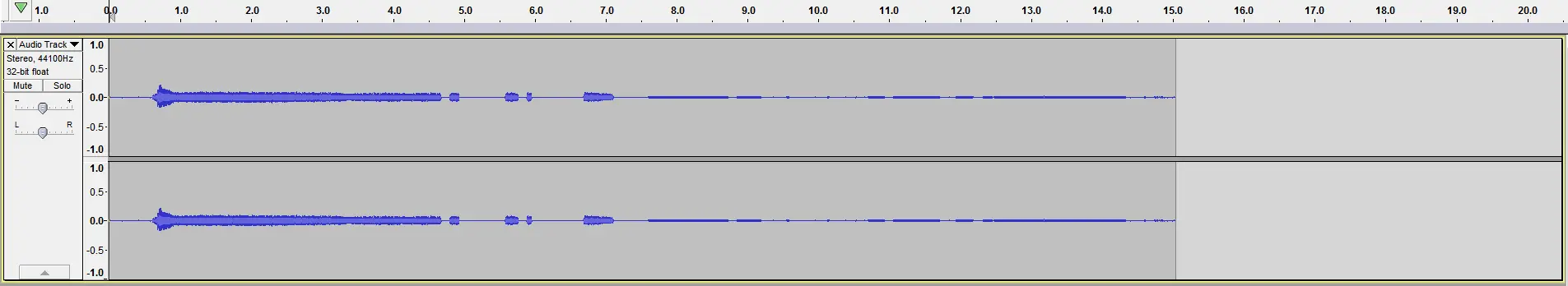

Could you record a held tone in audacity, as you described, and post it here please?
Hi,

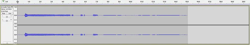

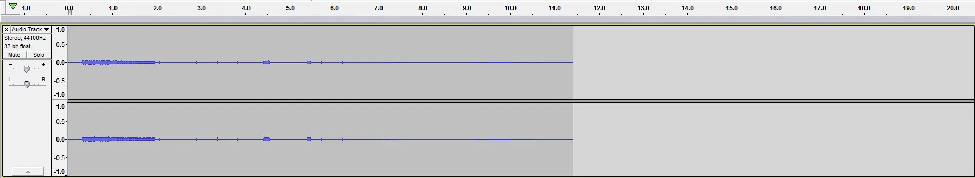

Here are two attempts; one continuous noise never changing tone or volume.
And here is the clip fror that file: Vocaroo | Voice message
Second attempt:
Clip for that file: Vocaroo | Voice message
My mic boost is at +20db by the way for both, and I kept the same distance, though my voice might have been a little louder on the second attempt without me realizing.
Oh, that's interesting.
It's properly cutting out and the volume seems diminished when it returns.

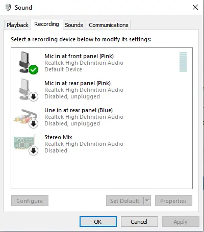

From your images it appears you're using the rear mic jack on the computer. Try the steps in the link below to disable the front jack and see if it helps. You could try the front mic jack first if you haven't done so yet
Here?s a Quick Way to Solve Realtek HD Audio Plugged and Unplugged Problem | SPYONTECH
I followed that tutorial and it didn't change a thing.

I have an update.
So I was tinkering around a bit with my audio settings of all kind after learning from that tutorial Arcaxis linked. I decided to use my headset's mic boom again and having my headset & mic it plugged into the front jack ports since somehow I had that designated more specifically for a mic, and now, I am no longer experiencing any cutting out or volume decreases. I have no idea what I did, barely did anything different, but I'm thinking me disabling my line-in and all other parts of my computer that weren't being used may have decreased possible interference? I am hoping that I finally fixed this now.
