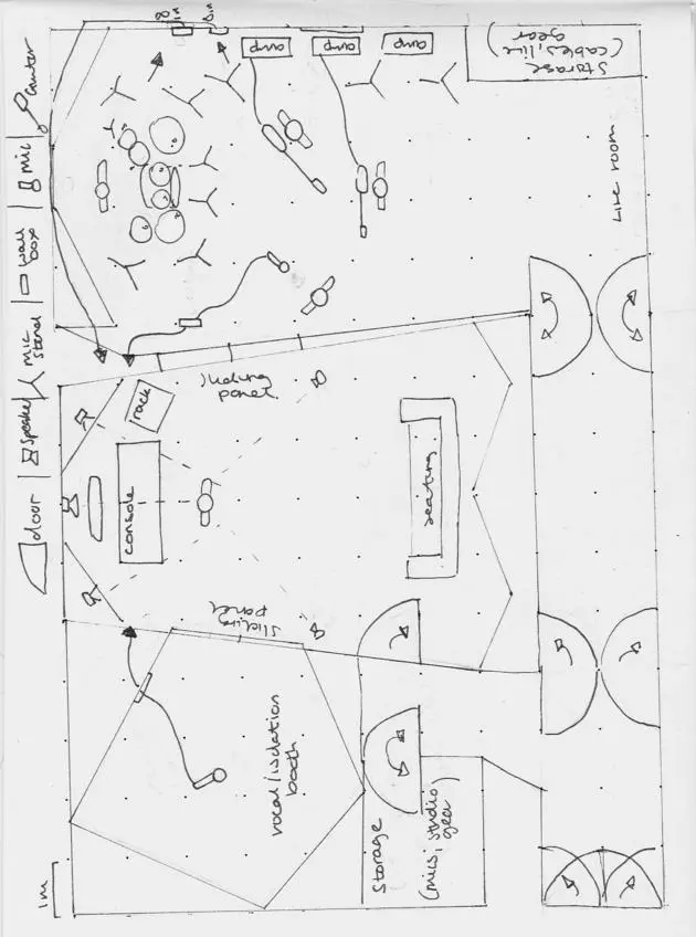

I have to design a studio layout for a university project. I'm not experienced in this kind of thing, but I've tried to incorporate what I do know. There's probably some glaring errors, so any tips, pointers, suggestions etc. would be welcome.
Room size: 15m(L)x10m(w)x5m(h) for both the live room, control room, storage, vocal booth etc.
Above will be a rehearsal room, and it will be beside a performance auditorium/lecture theatre that will likely have rock music levels of volume
The studio needs to be flexible in terms of the music genres/styles
The ground floor will be a of a block and beam construction, the first floor will be corrugated steel sheeting over a steel girder frame and concrete screed over it
Outside walls will be aircrete block (480kg/m^3), painted on the inside, zinc coated steel on the outside
Although I don't need to consider the following personally, I will need space for others to work on the following
