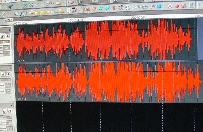

Here's two interfaces synced from the spdif of my word clock, so you did pretty good : )
That screenshot is brilliant; I'd never have expected so much variation with solid-state equipment. Much thanks for posting, garww. It really put things in perspective.
Well, if they were actually synced they wouldn't be so far off.
I guess I'm accepting "synced" as a relative term here. Because I know absolutely nothing about word clocks I had just assumed that, like the internal clocks of the recorders, there will be variance. If anything, it does tell me to expect variation, as you've already said...But I can't go anywhere beyond a naive and purely theoretical assumption of what I was seeing in that shot.
Quick edit: The tracks look to me about 15 minutes out-of-sync with each other (just by quickly eyeballing). That's enough for me to stop worrying about timings on my humble equipment! At least I know what to expect...But there's a need for more experimentation to find out how my clocks are drifting out of sync and hopefully be able to fit that data to some sort of curve. But that's a new ball of wax.
No, if the clocks are synced, they are synced. There will be no drift. If that weren't the case, digital audio and video simply wouldn't work.
So garww posted a screenshot of unsynced tracks? Hey, my average 1.25 seconds per hour isn't so bad after all. I'm glad I don't have to worry about this stuff on a regular basis since my Philips doesn't have SPDIF in.

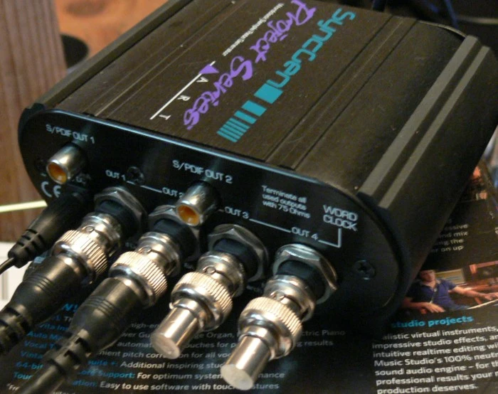

You mean they could be less far off : ) The discussion is fairly old about MFG & mags suggesting we only get decent clocking with internal. I suspect the same round of testing on my analog wordclock would be better. This was just black channel testing on a budget and one mid-line interface.
In my case, I just need to sync some random s/pdif with my Akai DR8. So, I wanted to see how random that could be. haha
