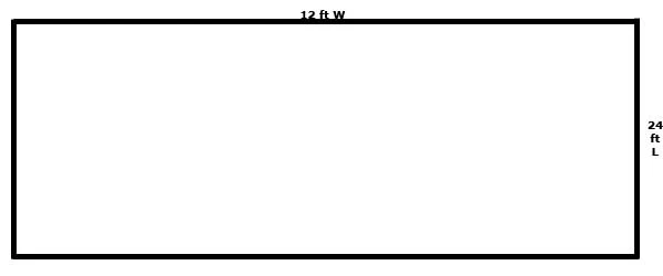

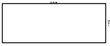

I'm attaching a crude image of the floor layout, and I figure the roof peak is about 20 ft, and then end of the slope is about 8-10 ft.

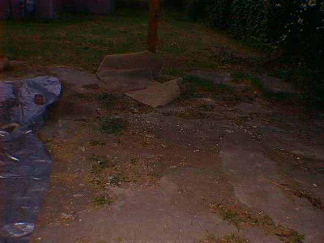

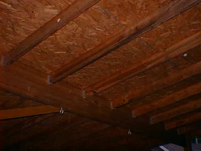

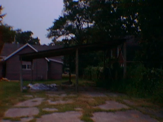

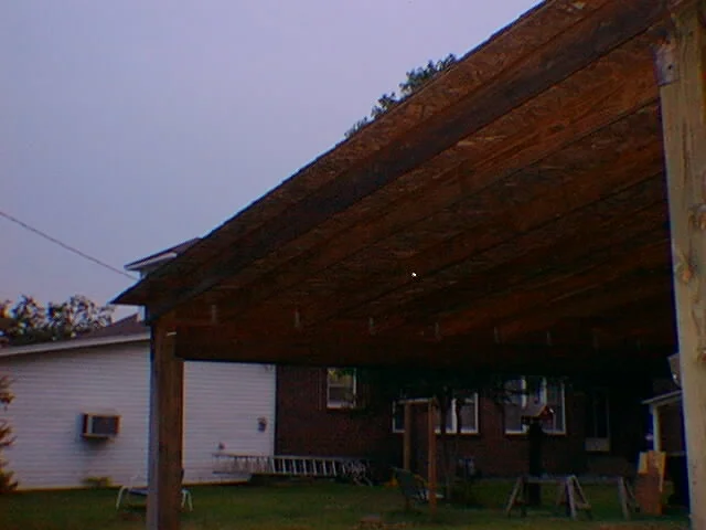

Photos!
Can anybody figure out a decent design, and how much it might cost to enclose this and insulate it?

Well, as I suspected, your foundation is basically non-existant.
"Pouring a layer of concrete over it" isn't going to fix it.
So that's one problem.
I couldn't tell by the photos if the overhang beams were 2x4's or 2x6's but either way they appear to be over-spanned.
So that's another problem.

You're going to need electricity to run everything. If its not inspected and done to code an insurance agency wont even touch you should there ever be an accident.
The foundation that you have isn't going to support the load of enclosing the walls. It might hold up for a while, but over time your walls are going to buckle and fail, not to mention rotting out at the base.

Yeah, I have to admit that the existing carport is pretty much a zero net gain. In other words what you gain by having the roof already there you lose by having to work around it being already there.
