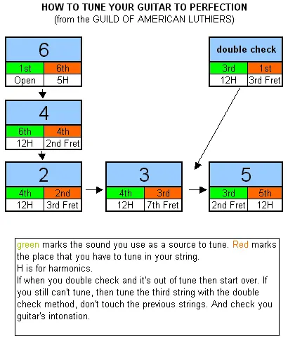

here's a chart that might help (see the attachement)

Thanks cordura
I was stumbling through the tuning there for a second but your diagram makes it easier. I can spend more time listening to the tuning than trying to figure out what the Guild document was saying. After looking at what you put up, and then rereading the Guild letter again, it all made sense.
Why do I get the feeling I just made myself out to be Forrest Gump. :D Oh well, at least I learned something.
Dick
It's funny how a six pack a Leinie's resolves all these tuning issues. Although the "Bob Marley" tends to have the opposite effect.
Evildick: no problem. I did the chart because I also find the document a little hard to understand. Cheers, Andrés
