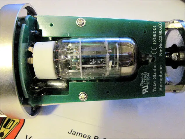

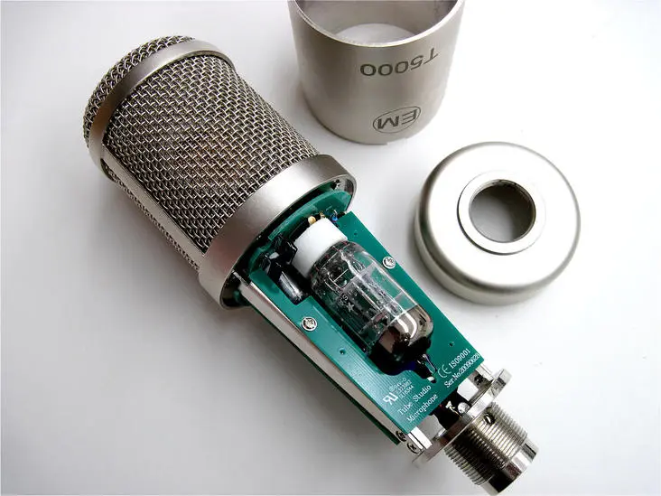

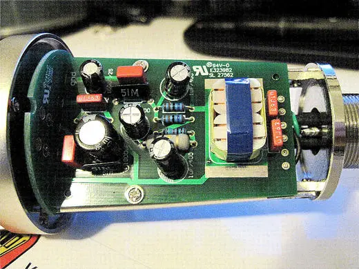

...just thought I'd pass along these options, as they just popped up...the eBay seller is clearly selling these mics at a very low retail price, as these mics wholesale for only about $30-40 less than he's asking (sans shipping fees)...I can recommend these, as I own one of them and I'm very familiar with the manufacturer (iSK/Shengke/TongXin) and the quality of their product...this same manufacturer makes product for KEL, AKG, Cascade, and many other reputable brands...these are very good quality entry-level tube mics, and the quality is definitively better than the stock Apex 460 or Nady 1050 (no cathode-follower secondary circuit, just a simple clean plate-follower)...these un-branded mics have higher grade WIMA caps, large 34mm capsules, dual bobbin transformers and are well built with the intended retail price to be twice ($300-400) what they are selling for here:

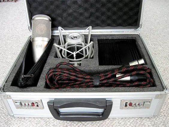

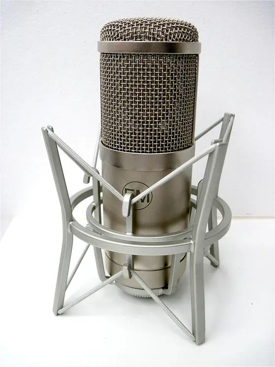

...here are some pics of the one I own (same or similar to #0407 above)...

Thread hijack: Do you have a schematic? That is a pretty sweet deal. I'm assuming that's a 12AX7? -- Never mind, google'd this and found out it is a 12AT7. Mmmh. Nice. I saw your "pre-modded" thread at GS just now....I've bought a few things from this seller too. Good guy.
...yes, these are very nice mics, even at twice the price...I recently shot out some of my mics at a pro-engineer friend's studio and he has a beautiful Gefell CMV563 (with an original M7 capsule) that was restored by Bill Bradley...after reviewing the results of the comparison, he commented on how similar my mic (same one pictured above) sounded to his vintage (and much more expensive!) Gefell...and another of the mics I brought, a new $1000+ boutique model (I'd rather not mention the brand) was the biggest disappointment...that one went back to the manufacturer...
...for the mic pictured above, I swapped out the stock 12AT7 tube for a NOS GE 6201 (12AT7WA) military grade tube after trying a GE 5-Star 6072...the 6201 sounds wonderful in that mic...very mid-forward, with none of the typical 'hashy' top-end common to some of the cheap Chinese tube mics...a great deal, no doubt!...
