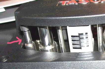

You would defiantly see wear from the tape edges on the erase head. I’m curious, how does it compare to the new one you have? My TSR-8 has very little wear, and the bands on the erase head are black, but otherwise exposed. I have seen others that are silver. Can you post a photo?
One potential problem area on the TSR-8 is the first guide pin (far left) on the head block. Look closely with a light while the tape is running in PLAY mode. If the bottom tape edge is curling on the base of the guide pin it can cause shedding. That shedding can end up on the erase head, which seems to catch loose oxide around the bands over time.
A tape with higher shedding would just leave more oxide behind at a greater rate than usual.
