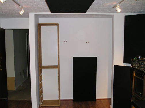

The wall behind my mixing position is anything but symmetrical. It's about 9.5 feet away the mixing position, so I've been advised in this forum to go for absorbtion rather than diffusion. I've only got ONE last panel of rigid fiberglass left, so I'm trying to figure out the best location for it on that rear wall -- the only wall that currently has no treatment on it.
The first photo shows one possible configuration, with the panel hanging vertically between the storage tower (currently empty) and the other end of the closet. (Obviously,the panel is not actually hanging yet. It's just sitting on the floor near where I'm thinking about hanging it.)

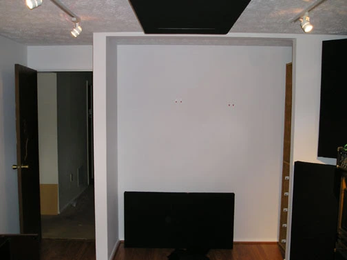

The second photo shows another possible configuration, with the panel "hanging" horizontally (at the level of my monitors), and with the storage tower shoved back into the closet's alcove.

Haps,
I think you'll do better to hang it horizontally, centered vertically at ear height. You should also space it off the wall as far as you can manage - one foot away from the wall would be perfect. This will extend the absorption to cover a larger area than the panel's physical size. That is, some of the sound that strikes the wall near the panel will "splash" a little and be reflected into the back of the panel where it's absorbed.
--Ethan

So you think I should hang the panel like in the second photo, but a with the panel moved a little farther over toward the middle of the closet opening and hung at ear height? You can't see the monitors in this pic, of course, but you CAN see a ceiling panel that is centered between the monitors. I take it you're recommending that I center it (left to right) on that?

> So you think I should hang the panel like in the second photo <
Yes, but not resting on the floor of course! Center it in both directions to align with your head.
