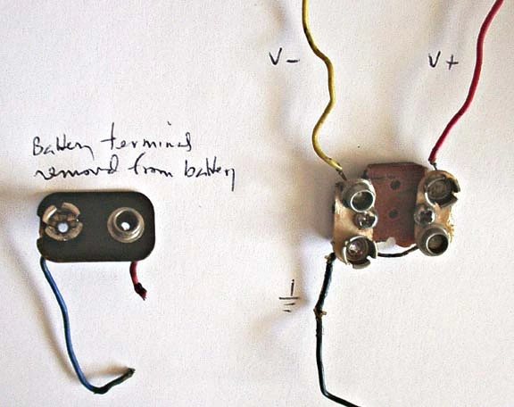

I'm not sure what your power supply is like. For this circuit you need a bipolar power supply - it calls for +/- 15V, but the IC can use anything from +/-4.5 to +/-18V. What this means is that you need a ground, a positive voltage above the ground, and a negative voltage below the ground. In your case the easiest way to do this would be with two 9V batteries. Hook the + terminal of one battery to the - terminal of the other - this is your ground potential. Then hook the + free terminal to V+, and the - free terminal to V-. This gives you a bipolar supply of +/- 9V, and should be plenty to run the preamp just fine.
BTW, if you have old 9V batteries, you can take them apart and use the old terminals as clips to hook the batteries to. Attached is a bipolar clip I made many years ago on a small piece of perf board.

No problem with offset voltage - see PRR's post in the link above.
Wow, thanks for the detailed pic doc, I really appreciate it!
