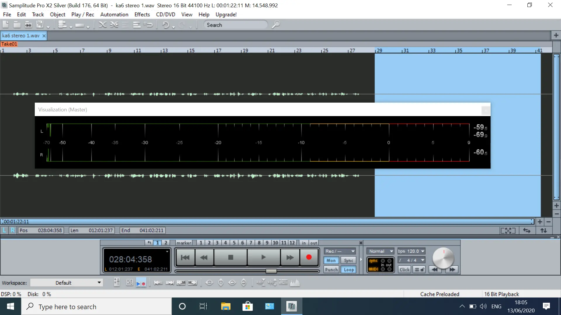

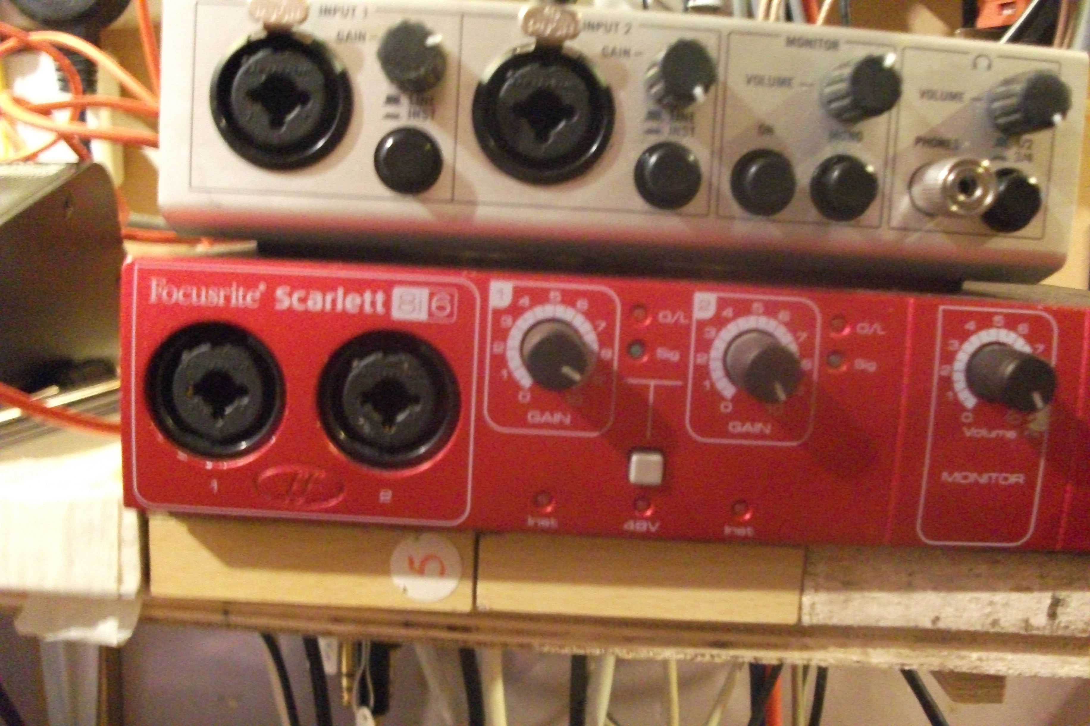

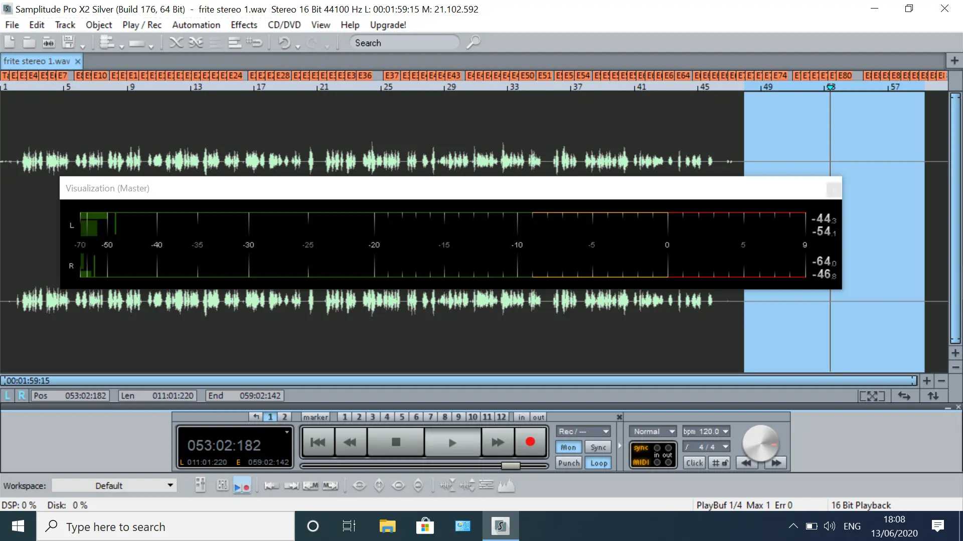

Here's a bit of work...
The 8i6 has more gain than the KA6 but might be a tad noisier? In any case I was speaking at about 200mm off mics and you would reduce that distance by a third to a quarter for a dynamic as a rule.
Note that a lot of the noise is PC fan rumble at 100Hz'ish and a HPF at 150Hz gives a considerably better noise floor. The extended LF response of the P150 does it no favours here.
