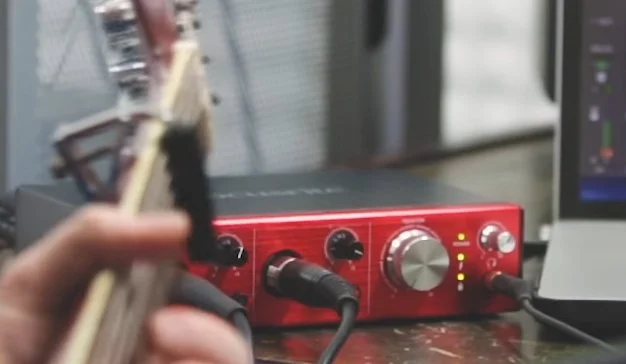

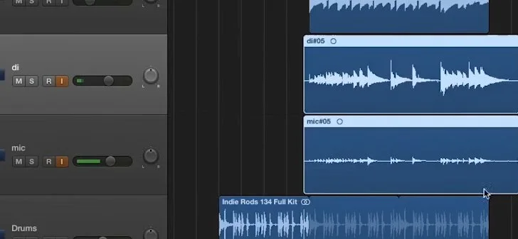

I had a focusrite clarett 4pre for 3 days. I could not get a usable signal out of it. Even with the gain turned almost all the way up, the signal was super weak. After normalization the noise floor was higher than any preamp I've ever used. I think it's the nature of the beast though. Watch the video on youtube (released by Focusrite themselves) where the dude records an acoustic guitar. "recording acoustic guitar with the clarett 2 pre" I'm new to this forum so I can't post the link
At 6:30 you can see the two tracks he recorded for a guitar part: one recorded direct and one with a microphone. You can see how weak the track recorded with the microphone is in the DAW even though he had the gain turned up almost all the way.
DO NOT BUY THE FOCUSRITE CLARETT if you need to use the onboard preamps for quiet sound sources. I'm sure drums or percussion would be fine
I watched that video and, yeah, that REALLY looks crazy low for a SDC mic level. The Sonotronics has a level of -36dB 12mv/Pa which is over 20dB higher than an SM57, and on par with something like the Rode NT5. There's no way it should be cranked that high for the signal level he's getting. I get that from an SM57 on my Tascam! It makes me wonder if Focusrite under engineered the mic pres on the Clarett line.
