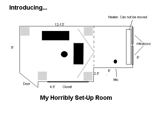

Alright, I feel like an ass having my room set-up this way for almost three years, but here it is. I drew a pretty basic diagram of the room and where I currently have things placed. It is, of course, not to scale, but the deminsions that I included are pretty accurate (but the two desks are bigger than they are in the pic in scale to the room).
I drew a dotted line where I had initially intended on boxing off as a "recording booth." The heater by the windows is not movable and the windows are covered with blankets.
If any of you have any suggestions of where I could move stuff around and where I can place foam etc. please let me know. I am already extremely greatful of the time you took out so far to help me out.
Thanks again,
-Springfield

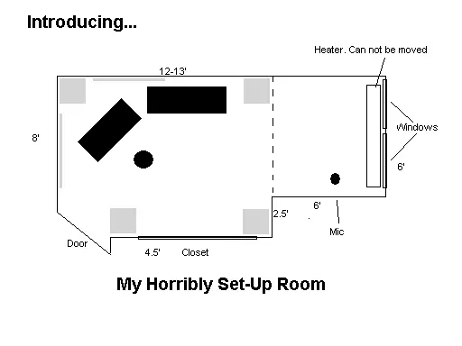

I am going to modify your picture with a suggestion... may take a few minutes.
My first thought was messed up by the door, which I didn't notice at first...
But here is my current thought on placement. The gray areas are treatment. The boxes represent bass traps and the lines, panels. I think you would be best with the stand mounted Lenrds and a MaxWall. You could position them anywhere you needed them. Notice that I moved the console away from the wall to get it out of that corner.

If the heater is just something that is low to the ground you could consider putting 2 of the bass traps back on those corners instead of closer to the mixing position. I think the dotted line threw me off a little bit. Also, if you leave the door open when you mix the bass will have an escape route in that corner.
You could just move the wall to get to the recording area and the wall itself will act as a wall for your booth.
Thanks. I'm gonna look into getting that maxwall even though it'll take some time to save the dough. So you think the console facing the corner can stay? I was hoping so, because if I move it too much around, it kind of clutters up the room. I understand your saying move it out more, but thats no prob.
What about secluding that area from the dotted line to the right to make it sort of a vocal booth? Any thoughts on that? It's kind of shaped perfectly so that I can place a barrier there and it wont effect any of my desks. Just a thought.

Damn, you post two replys before I can post one. Yeah, that second diagram looks like it may work. I am no seriously considering that maxwall. So if I were to get a maxwall and four basstraps, what'll that run me? Like $800 or could I get by for less?

Well, the second diagram I posted may solve a lot. It partitions off the vocal booth with acoustic treatment and gets you out of the corner. You may want some panels on the wall near the keyboard (?), but I forgot to add them in. If you wanted to keep the console in the corner you could still find ways to partision off that booth. Either with a MaxWall, or by making a movable wall and gluing acoustic foam to it. The MaxWall is just so easy to move around though. You could make a booth out of some MaxWall panels alone. I would definitely move the console out as much as possible to get the monitors out of the corner.

Both the MaxWall and the stand mounted Lenrds together would cost about $600.00, not including shipping if you can't find them locally. It would be less if you got the regular Lenrds, but you don't seem to have have many places to mount them. You could move the stand mounted ones around until you found the spots that work best.
