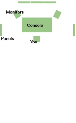

Another thing you may want to consider is how you have things setup. I could not tell from your diagram, but your monitors should be centered in the room with an equal distance between the side walls and monitors. The monitors should be closest to the wall behind the console (distance depends on the monitors and the room and you may need to move them around to find the best spot) and facing lengthwise. So if your room is 15' in length, the greatest distance of the room should be behind you. Also keep monitors out of corners and try to avoid setting everything up so that it is diagonal.
I attached a VERY rough diagram I did for you.
