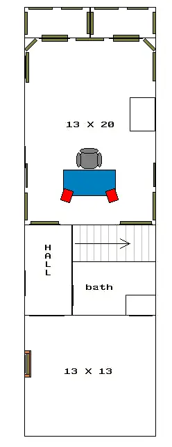

I did a quick drawing of what my recording area looks like....not sure if it will help anything but here it is....
Thats a nice space you have there.

Here's what I'd do(treat the drum room a bit too).

pandamonk said:
Only problem i can see for the 13x20 room is the doors in all corners.
this would be a problem on the two doors towards the center. The two doors that lead into the two closets (booths) are about 16 inches from the corners. The one that leads into the hallway and under the steps are only about 2 inches from the corners.

Pandamonk...in the drawing that you adjusted...would all of those panels you suggested be made of the same material? or should I ask if broadbands and bass traps are constructed the same way?
Well if you have 2" broadband absorbers, you should atleast get a 4" 703 for bass trapping. I think it's better just to use 4" for all.
but what are the differance other than where they are placed? are they constructed the same way?
Well, you need thicker materials to absorb bass frequencies since they have larger wavelengths than high frequency wavelengths. yeah you can construct them in the same way. build a frame out of wood, place the fiberglass and wrap the entire thing around with burlap or any breathable material.
The bass traps I've put are broadband absorbers, just placed at the corners. You might want to make broadband out of 2" and bass out of 4-6" if you need to save money, but I'd do them all 4" if not.
