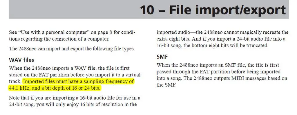

Did you follow the criteria for sample frequency and bit depth when exporting from Cubase? That's the most common reason the NEO won't like it.

I figured it out I was doing everything except using the wav folder in the drop down. Thanks to all for your help.
