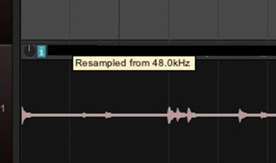

Is this something of concern?

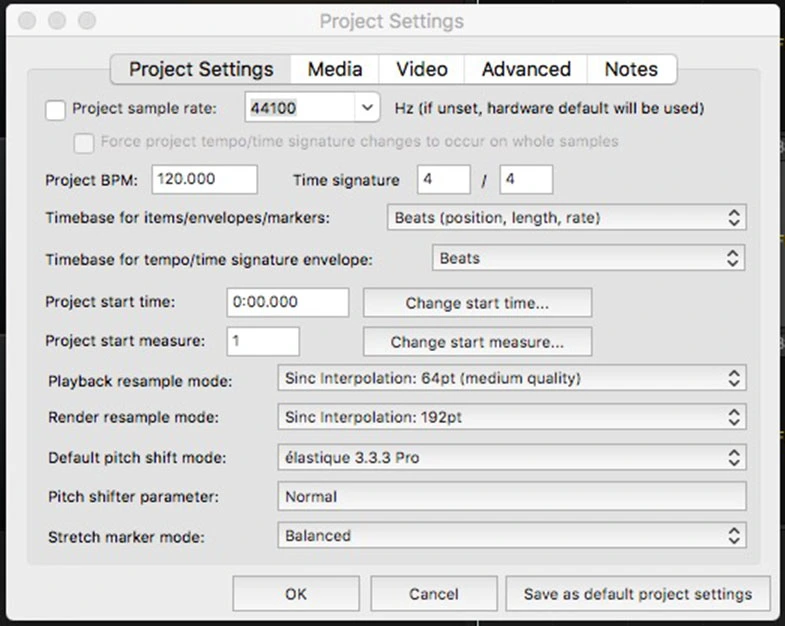

You recorded at 48kHz sampling rate but your audio interface is now set to a different sampling rate. Go to File->Project Settings and check the playback and render resample mode. Check these are set to R8Brain which is almost transparent. The default used to be a fairly low quality setting which made everything sound a bit fuzzy but they may have changed that recently. If you don't want to resample then you could also tick the Project Sample Rate box in Project Settings and choose 48000 on the dropdown box.
It's not the worst thing that could happen, but it's not ideal and it should be fixable or preventable.
Did it happen immediately on recording or after opening the file in a new project?
Normally, you'd pick a sample rate for a project and set the interface to match. In most cases with basic systems, the interface detects the project settings and matches itself, but occasionally there's a lapse of communication between the DAW and the interface. For example, if the interface only goes to 48 kHz but you have a project set to 192, I could see something like that happening (though I would normally expect an error message saying the interface couldn't match the project settings).
These are the settings:
but I'm wondering can this be the result of not having the interface connected, and listening through just the mac?
It could be due to that. It warrants more investigation.
Yes, if Reaper is set up to read the settings from the audio device, then if you unplug the interface and go to the internal audio chip, and the two have different settings, then it will start up in a different profile. In any case, I have never had an issue with Reaper's resampling.
Also, Reaper does non-destructive editing, so if the original file is 44K and you fire it up into 48K, it doesn't change the original data. It just remembers everything you did up to the current point (as far as editing, eq, etc). Ultimately, when you render the file it will set to whatever values you pick.
For archival purposes, I always capture to higher sample and bit rates, and then when I mix down to 44K, I dither the mix. Then it can be burned directly to a CD. The Clarett+ can sample up to 192K, I believe. My Tascam does 96k, but I usually do everything at 88.2k which is double the CD standard.
Yes, the Mac is probably working at 44.1kHz while your interface was working at 48kHz. Whatever you do you MUST change those resample mode settings because those settings will sound pretty bad. Make sure you also change them on the default template and any other templates that you use.
Yes - this icon disappeared when I connected the interface.
As for the resample modes - these should be set to the highest quality?
