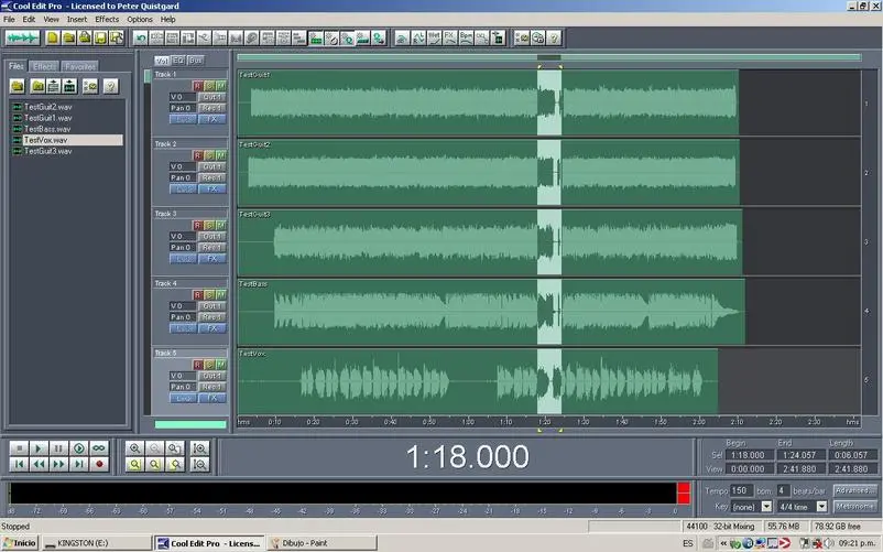

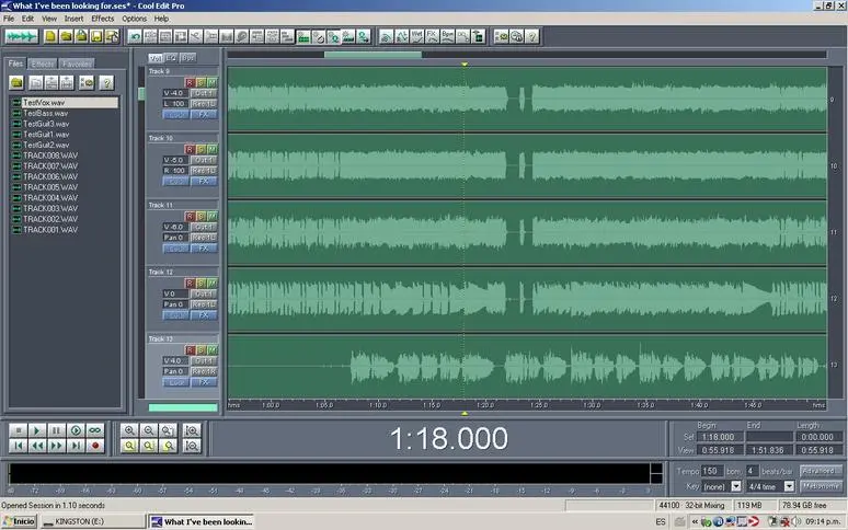

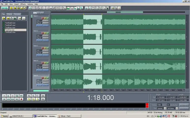

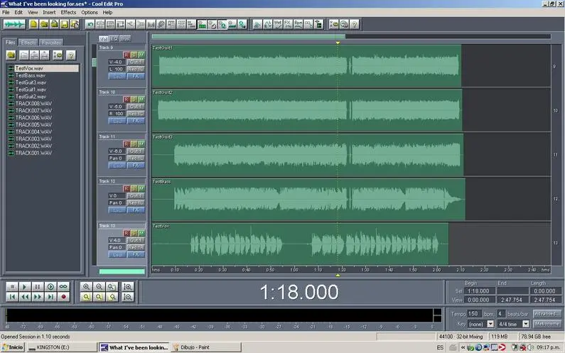

I got pics to best describe what I'm talking about.
Screenshot 1: Zoomed in pic of the tracks as they were recorded in the session.
Screenshot 2: Zoomed out pic of the tracks as they were recorded in the session.
Screenshot 3: Zoomed in pic of the tracks being inserted in a new session. Notice how they differ.
Screenshot 4: Zoomed out pic of the tracks being inserted in a new session.
Hope this explains better than my words.
Again, any info will be much appreciated!
