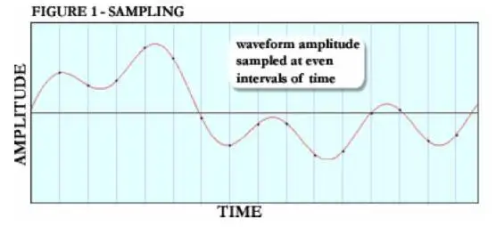

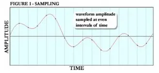

Just as an FYI...
Digital meters (well the vast majority of them) cannot accurately read the real peak which will be recreated at the DA. Close enough but not quite, which is another reason why headroom is a good idea.
In the graphic below you can see how the actual waveform that will be recreated at the DA is peaking higher than the digital meter can represent. The digital meter can only mark peaks at sample points, not in between.
The dots in the photo are what the digital meter will display, the actual re-created waveforms will at times exceed that. The only way to remedy that is to use do re-construction before the meter. I think some of the newer digital formats might do that (DSD?) not sure.
From Nika Aldrich's "Digital Metering" paper
