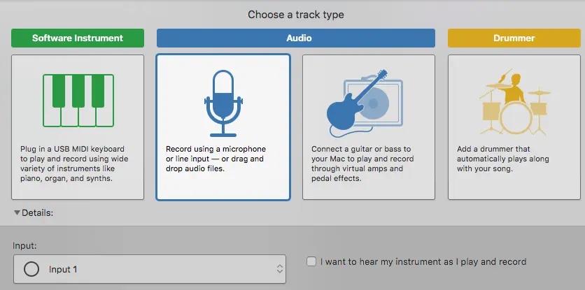

You can also just add another audio track without setting it up as a vocal track - not sure what you mean when you say the 2nd input "went to a vocal track?" Are you starting with a new, empty project and just adding 2 tracks with the "Choose a track type" dialog (attached - this is GB 10.2.0 BTW)?

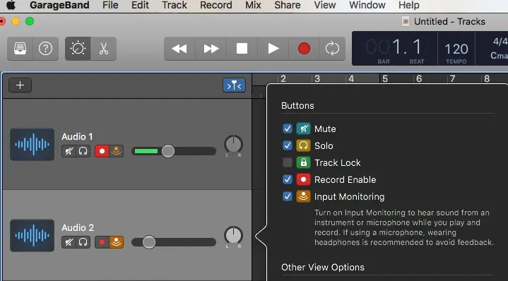

To follow up [MENTION=196554]Gtoboy[/MENTION]'s comment, you need to make sure that your interface is set so the headphone output is from the DAW, i.e., the MIX control is turned to the right, and not from the input (MIX control turned to the left). AND, you must have input monitoring enabled for both channels you are recording, and make sure both are recording. I would change the Track Header configuration to include the Record Enable button, so you know which ones are actually tracking when you press the red record button at the top. When a track is recording, and input monitoring enabled (button is green), it will play back in your headphones from the DAW. (If a track is not recording, even with input monitoring enabled, you will only hear it back from the DAW when it is the selected track.)
GarageBand for Mac: Turn on input monitoring for audio tracks
