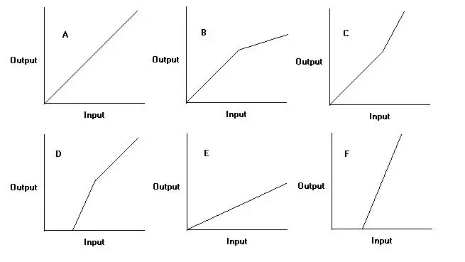

OK, I tried to attach a file with some Output vs. Input curves to help explain this in case someone can't visualize it. (I'm really not trying to be patronizing, just trying to help...)
So, curve A represents the unaltered signal - a line with a slope of 1 - what goes in comes out. Curve B represents the compressed signal where beyond the kink in the curve (threshold), the output is reduced according to some ratio and the slope of the line decreases. Curve C is the output vs input for signal A minus signal B (the result of Jakob's method). Compare curve C to curve D (the curve for an expander) and you see there is a difference. With curve C, the output increases above the threshold according the inverse of the ratio in curve B. With the expander curve shown in D, below the threshold the output is decreased according to some ratio and above the threshold, the slope is still 1 and the signal is unchanged.
If you compress signal A with a threshold of minus infinity, you get the graph shown in curve E - the slope of the entire line decreases. Subtract curve E from the original signal, curve A, and you get curve F, the slope of the entire line increases like the lower half of the expander curve D. Compress the signal again and you get curve D, the same as the expander. I think this is the real answer to the question.
Hope the visual aids help a little. Let me know if that didn't make sense.
thanks a ton for all the help everyone. i get it now. FINALLY. thanks a lot for the drawings ebeam. they really helped. im going to keep them and put them in my notes. ha. awesome. im sure ill be back soon with another question because my professor likes to mess with our heads such as this. thanks again.
