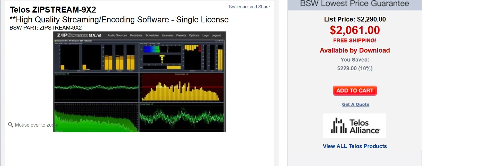

Oh my! I found these VSTs broadcast processing softwares. $2000+ for a VST with no FREE TRIAL whatsoever..
Im just not crazy enough for this...You think they will have a sale like the Plugin Alliance? Reg $2061.00 Sale price $29.99! No
Quote an assumption they have:
The 9X/2 is not simply a streaming processor-encoder, but a complete audio management system that will actually improve the flaws found in most recorded source material – both music and voice – as well as address the specific technical challenges of Internet.
