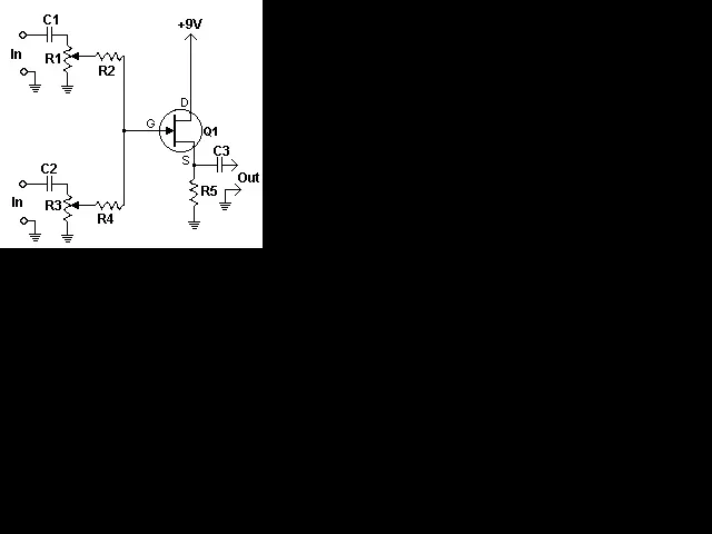

Doesn't sound too complicated to make. Basically it's an effects send. Rewire a volume pedal; start with a buffer stage, send one output to the pedal, and one output to the pot on the volume pedal.
Here's something similar to blend two pedals:
http://www.aaroncake.net/circuits/mixer1.htm
That with a buffer stage in front of the guitar in should work; I think it should be possible to use a single pot instead.

Depends on the source. If you wanted a totally passive circuit with a guitar input on one side, 100K should work OK, 250K might be better. If it's two pedal input, 10K.
The more I look at the diagram, the more it doesn't look like it's setup for what we're talking about. I don't think that schematic would allow you to play through your pedal and gradually sweep into the effect while maintaining a solid signal. I.E. Uneffected guitar gradually sweeping into distorted guitar maintaining a constant volume rather than insta on, insta off.
It's not, but it's similar.
Here's something I sketched real quick but I haven't thought about too hard. Thus this circuit could have errors in it.

I'm not sure what you are trying to do--are you trying to add a blend pot to each pedal? My schemo is more of a "master" blend control intended as a volume pedal mod (where the volume pedal is just a simple pot, no active electronics).
If you are modding an existing pedal, you'd need a lot fewer parts, since it already has a buffer. Just tap right after the buffer to one side of the blend pot, and move the effects output to the other side, and wire the output of the mix resistors to the output jack.
You'd still need some makeup gain, but you can get that from another pedal, or your amp.

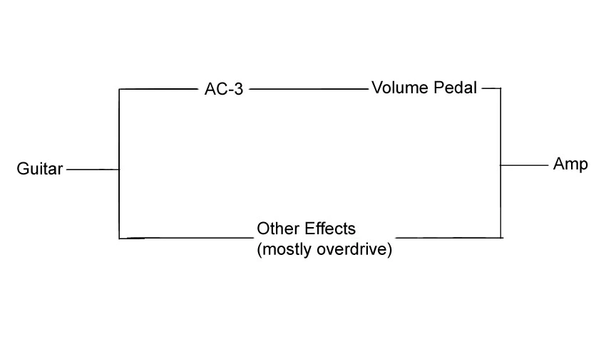

I have a Boss AC-3 that i use to thicken up my sound sometimes. Its kind of similar, not exactly what the original subject pedal does though.. Its an acoustic simulator for those who dont know.
No electronics needed. I just use a couple 1/4 inch splitters.

Yes you're right. I don't use it alot, but if i just wanna use the acoustic simulator, i just bypass the other effects and crank the volume pedal. And yes I know there is some pure signal coming through right from the guitar, but I honestly dont hear it, the AC-3 must have loud output.
I really like using chorus and acoustic at the same time. That i do do alot.
