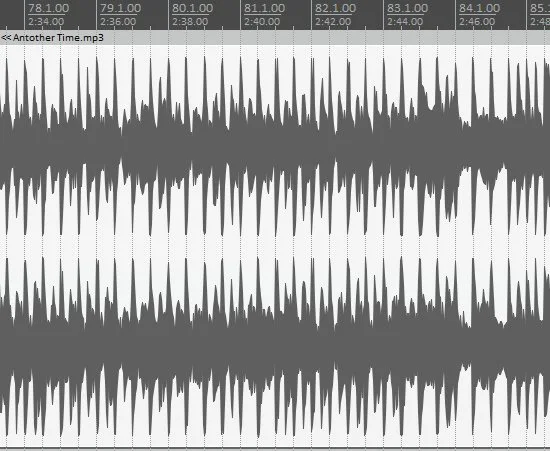

Uploading a new mix of Another Time. Does it sound better? Or just the same? Sounds somewhat the same to me on my phone but it sounds better to me on soundcloud this time. Not great, just better. Sounds like there's levels out of whack for certain parts on soundcloud. Crazy. I'd have thought if a mix sounded ok on a phone it'd sound ok on a laptop. But that doesn't seem to be the case. I should have linked to soundcloud so you could hear just how squashed and weak the 1st version's drums were. The 2nd version kind of survives the soundcloud playback better. Yet they sound similar on the phone.

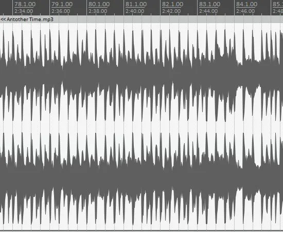

Listening to the two tracks, I think the problem is more that the snare level is high relative to the other drums. It really pops out. When I look at the track, all you see are the snare peaks, which seem to be 3-5dB above all the rest of the music. I have the snare in my MTPDK pulled down compared to the toms. Plus, they are very precise, each hit it basically the same dynamic.
Can EZD "humanize" like MTPDK? You might try to do that on the snare drum, in addition to pulling the level down some. Drummers will vary things to keep it interesting, otherwise it can sound too much like a metronome.
Great way to show beginners how they can see the problem!
